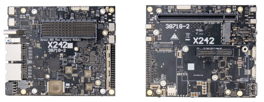

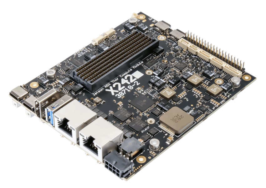

The Auvidea X242 is a premium carrier board designed for the NVIDIA Jetson T5000 (also known as Jetson Thor) system-on-module, offering a powerful, scalable, and flexible platform for advanced robotics, edge AI, and embedded computing applications.
The X242 is built as an industrial-grade platform while allowing the Jetson T5000 to operate at its full potential. The module features a Blackwell-architecture GPU delivering up to 2070 FP4 TOPS of AI performance and supports up to 128 GB of memory. This combination makes the X242 well suited for real-time AI inference, sensor fusion, autonomous machines, and multi-sensor robotics systems.
Auvidea X242
Auvidea X242 Specifications:
  • Designed for NVIDIA Jetson Thor T5000 (Jetson T5000) SoM
  • PCIe Gen 5 support with up to 32 Gbit/s per lane
  • PCIe x16 slot supporting PCIe Gen5 x8 (rev 3 only)
  • M.2 Key M 2280 slot for NVMe SSDs (PCIe Gen5 x2)
  • M.2 Key B slot for 4G LTE / 5G modem cards (USB 3.2 Gen 2×1)
  • 16-lane CSI-2 camera connector, compatible with NVIDIA P3762 camera module
  • Up to four simultaneous displays:
    • 1× HDMI
    • Up to 3× USB-C with DisplayPort Alt Mode
  • USB connectivity:
    • 1× USB 3.2 Gen 2×1 Type-A
    • 4× USB 3.2 Gen 2×1 Type-C
  • DisplayPort Alt Mode over USB-C
    • 1× single-cable touchscreen support (rev 3 only)
    • 2× DP Alt Mode configurable via device tree
  • Dual 10GbE RJ45 ports based on Realtek RTL8127 controllers
  • On-board Wi-Fi 5 and Bluetooth 5.0 module (LM843)
  • Industrial I/O and control:
    • 1× CAN bus with transceiver
    • 1× CAN RX/TX (external transceiver)
    • UART debug interface
    • 2× I²C headers
  • On-board MCU with ATSH204A hardware security crypto chip
  • Auto flashing support for development and production
  • 12V PWM fan connector and GPIO-controlled RGB LED
  • RTC support
  • Wide-range power input: 24V to 48V DC
    • Up to 120 W operating power
    • Power supply designed for up to 300 W
    • Overvoltage, reverse voltage, hot-swap, and hot-plug protection
  • 3.81 mm pluggable locking power terminal
  • Industrial temperature range: −40°C to +85°C
  • Compact form factor: 125 × 104.6 mm
  • Backwards compatible with X23x carrier boards
  • Enables easy upgrade from Jetson AGX Xavier / Orin to Jetson T5000
  • Suitable for commercial deployment at scale
Auvidea X242 Top and Bottom
