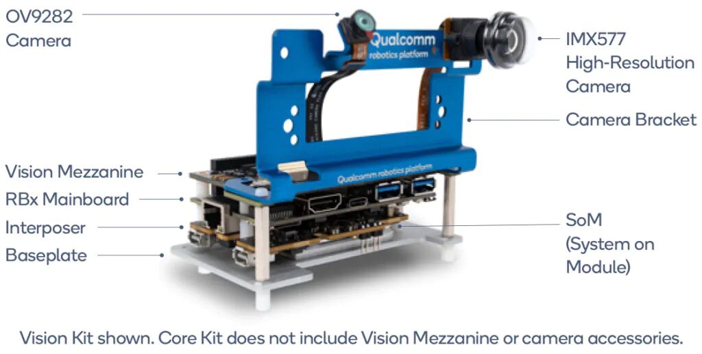

The development kit includes hardware that complies with the 96Boards open hardware specification, allowing for a range of mezzanine-board expansions, starting with the Vision Mezzanine. The Qualcomm® Spectra™ ISP 570L image processing engine delivers exceptional photography and videography experiences. It supports connections to multiple cameras, including stereo, depth, and Time-of-Flight (ToF). The Qualcomm® Adreno™ 633 VPU provides UltraHD video encoding and decoding, while the Adreno 1075 DPU supports both on-device and external UltraHD displays. Additionally, the kit features multi-gigabit Wi-Fi 6E for fast wireless connectivity and low latency, along with advanced features such as Qualcomm® 4K QAM and support for high-speed 160MHz channels.

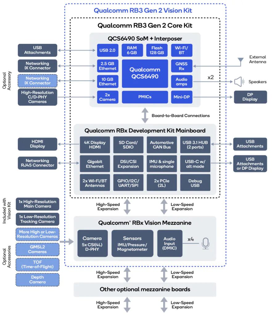

Block Diagram
The Qualcomm® Kryo™ 670 CPU and Qualcomm® Hexagon™ processor with a fused AI-accelerator architecture ensure powerful connections and computing performance. This makes the RB3 Gen 2 development kit ideal for various industrial and commercial IoT applications, including ruggedized handhelds, human-machine interface systems, point-of-sale systems, drones, kiosks, edge AI boxes, and connected cameras.
Qualcomm RB3 Gen 2 platform is available for pre-order now on Thundercomm for $399 (Core Kit) and $599 (Vision Kit) with a 12V wall power supply, a USB Type-C cable, mini speakers, a setup guide, and a pick tool for setting switches, and the Vision Kit also adds a mounting bracket for the high-resolution and low-resolution CSI cameras part of the kit. More details may be found on the product page.
