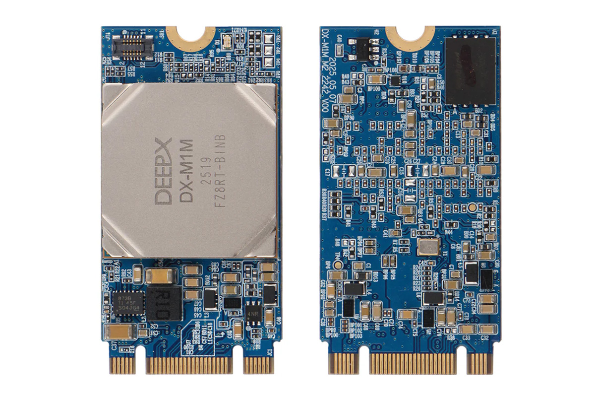

Radxa AICore DX-M1M Front and Back View

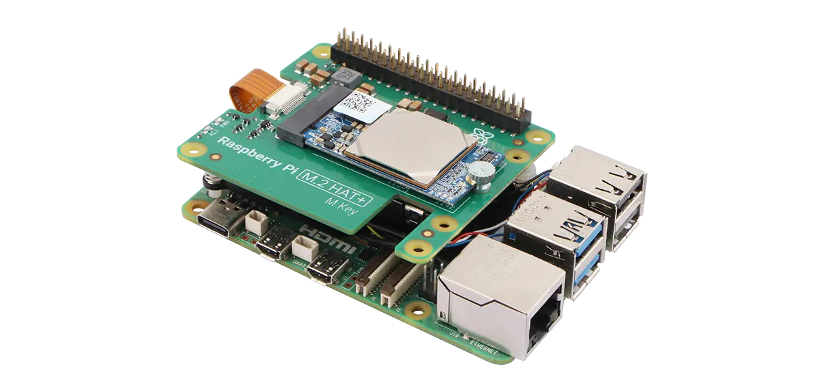

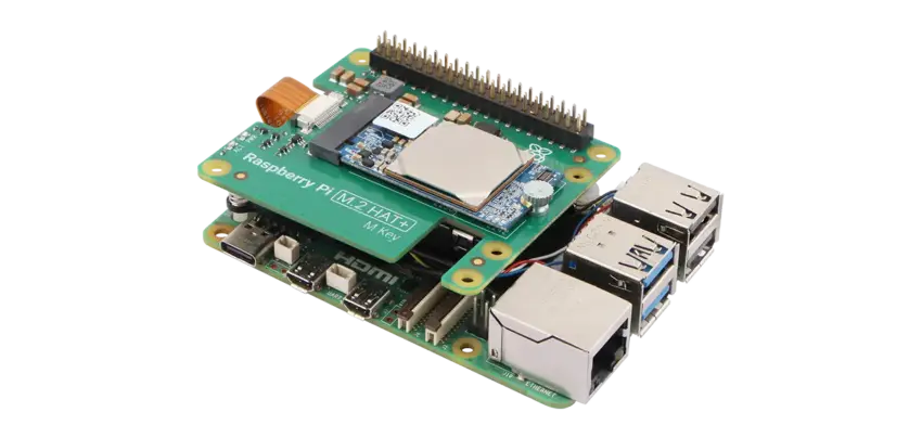

Radxa AICore DX-M1M installed on a Raspberry Pi 5

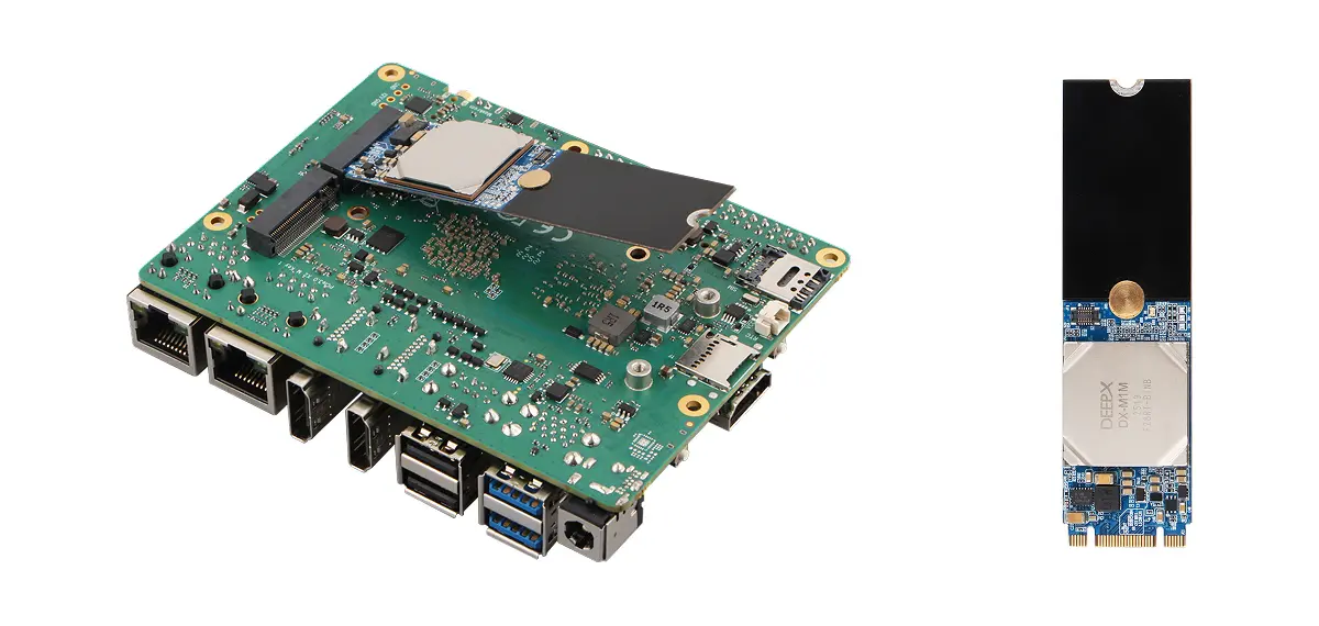

DX-M1M Installation
