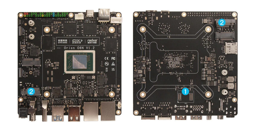

Orion O6N Nano-ITX SBC Front and Back Side
The Radxa Orion O6N supports Debian and Ubuntu Linux distributions out of the box, providing a full desktop experience with UEFI boot via EDK II. Developers get access to a complete Board Support Package (BSP) and Software Development Kit (SDK) for custom builds, kernel modifications, in the documentation and download section of the products page, but the documentation section is under development. But you can check out the docs for the earlier O6 to get an idea.

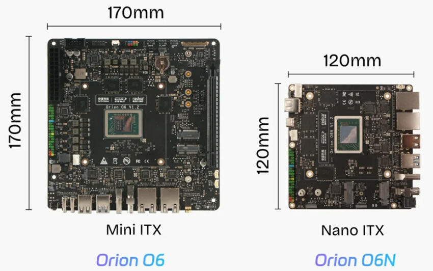

Orion O6N Nano-ITX SBC Dimensions
The Orion O6N Nano-ITX SBC is now available through Artech for $199 (32GB RAM variant), and you can get $12 off with the coupon code ARACE-O6N.
