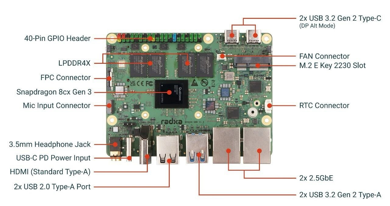

Radxa Dragon Q8B Edge AI SBC
The Dragon Q8B is built for Edge AI, Arm-based NAS, and smart gateway applications. It offers high performance in a compact 100 × 75 mm board and is designed to run Linux with open-source software tools.
Dragon Q8B Specifications:
  • SoC: Qualcomm Snapdragon 8cx Gen 3 compute platform
  • CPU: Octa-core (4x 3.0 GHz Kryo Prime cores, 4x 2.4 GHz Kryo Efficiency cores)
  • GPU: Adreno 690 GPU with DirectX 12 (DX12) API support
  • DSP: Qualcomm Hexagon Processor, Qualcomm Sensing Hub
  • AI: Qualcomm Neural Processing Engine SDK support (up to 29+ TOPS)
  • System Memory: Up to 32GB LPDDR4x RAM up to 4266 MT/s
  • Storage:
    • MicroSD card slot
    • UFS 3.1 module connector
    • Up to 2x NVMe SSDs via M.2 Key-M PCIe Gen3 sockets
  • Video Output: HDMI 2.1 port, 2x DisplayPort 1.4b via USB-C ports up to 4Kp120
  • Audio: 3.5mm audio jack, Microphone connector
  • Networking: 2x 2.5GbE RJ45 ports, Optional WiFi/Bluetooth via M.2 Key-E socket
  • USB: 2x USB 3.2 Gen 2 Type-C (with DP Alt. Mode), 2x USB 3.2 Gen 2 Type-A, 2x USB 2.0 Type-A
  • Expansion:
    • M.2 Key-M 2280 (PCIe Gen3 x4) socket
    • M.2 Key-M 2280 (PCIe Gen3 x2) socket
    • M.2 Key-E 2230 socket for WiFi/Bluetooth
    • 40-pin color-coded GPIO header with UART, I2C, SPI
    • 16-pin PCIe Gen3 x1 FFC connector (Raspberry Pi compatible)
  • Misc: Power button, RTC connector
  • Power Supply: USB-C PD connector
  • Dimensions: 100 x 75 mm

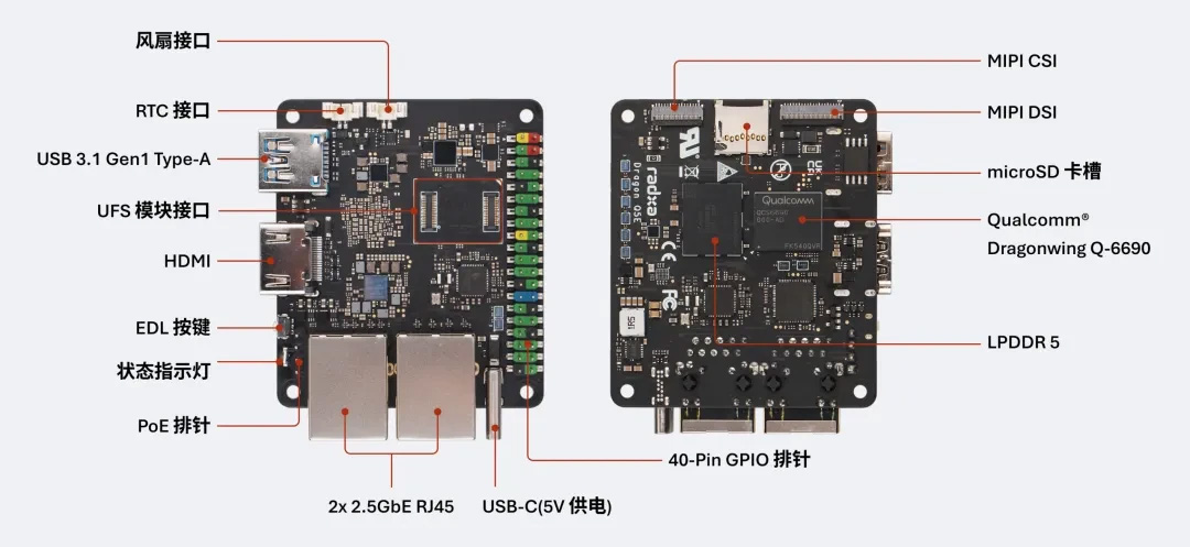

Radxa Dragon Q5E SBC
The Dragon Q5E is designed for compact applications and supports Debian-based Radxa OS and Ubuntu. Radxa will also provide detailed documentation on its website.
Dragon Q5E Specifications:
  • SoC: Qualcomm Dragonwing QCS6690
  • CPU: Octa-core Qualcomm Kryo 7-series (1x Kryo Prime @ 2.0 GHz, 3x Kryo Gold @ 2.0 GHz, 4x Kryo Silver @ 1.8 GHz)
  • GPU: Qualcomm Adreno GPU 7-series
  • DSP/ISP: Qualcomm Hexagon DSP with HVX and HMX / Qualcomm Spectra ISP 665
  • VPU: Video Encode up to 4K @ 60 fps (H.264/H.265); Video Decode up to 4K @ 120 fps (H.264/HEVC) and 4K @ 30 fps (VP9)
  • AI Performance: 6 TOPS (4nm Process)
  • System Memory: Up to 16GB LPDDR5
  • Storage: MicroSD card slot, UFS module interface
  • Video Interfaces: HDMI port up to 1080p90, 4-lane MIPI DSI connector
  • Camera: 4-lane MIPI CSI connector (up to 32MP camera)
  • Networking: 2x 2.5GbE RJ45 ports (one with optional PoE, using PCIe Gen 3)
  • USB: USB 3.1 Gen 1 Type-A port
  • Expansion: 40-pin GPIO header (UART, SPI, I2C, I3C)
  • Misc: Power/EDL buttons, RTC battery connector, PWM fan connector
  • Power Supply: 5V via USB-C port
  • Dimensions: 65 × 56 mm

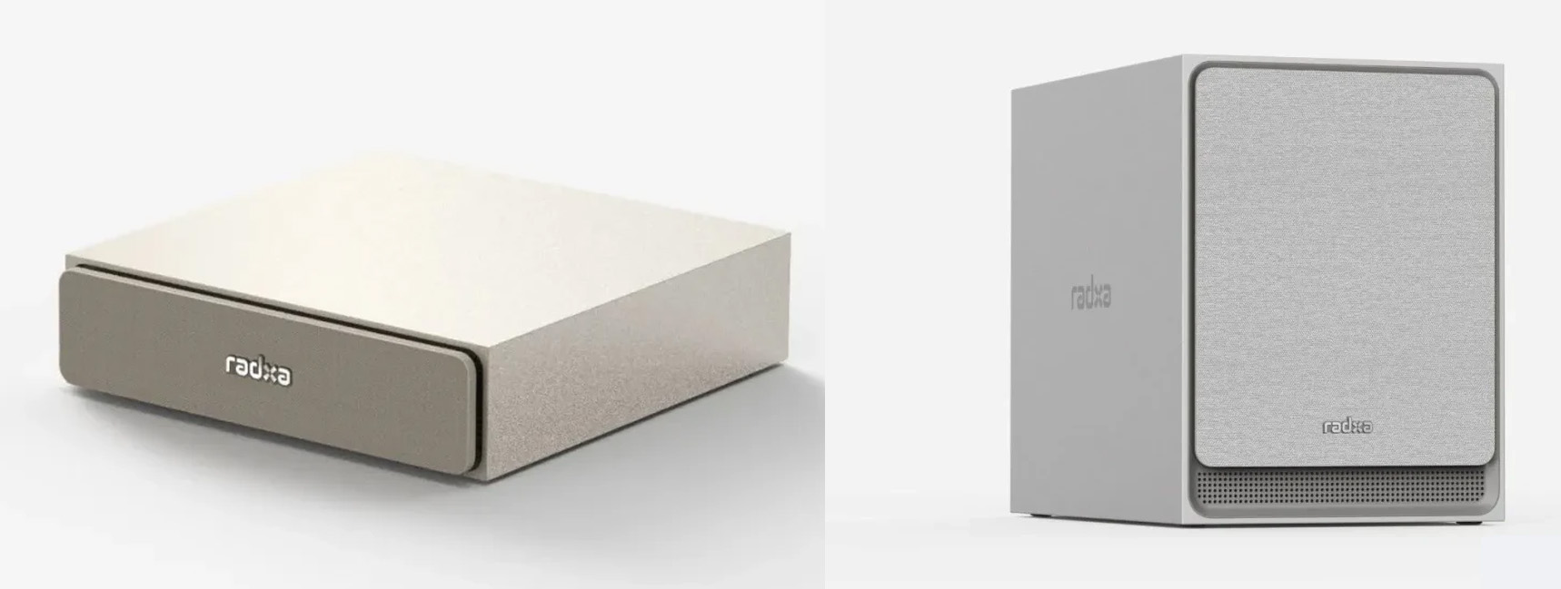

DragonStation and DragonBay NAS Systems
In collaboration with FeiNiu, Radxa is developing two Qualcomm-based NAS systems that enable support for fnOS:
  • DragonStation: A high-performance 6-bay M.2 NVMe SSD NAS featuring 10GbE networking. Enhanced with an AI accelerator card, it supports the operation of 120B local models and agents such as OpenClaw and Hermes.
  • DragonBay: A mainstream 4-bay NAS built on an unnamed Qualcomm mobile platform. It is aimed at high-capacity storage, media libraries, photo archiving, data backup, and multi-user file collaboration.
Further technical details about the two NAS systems have not yet been released.
