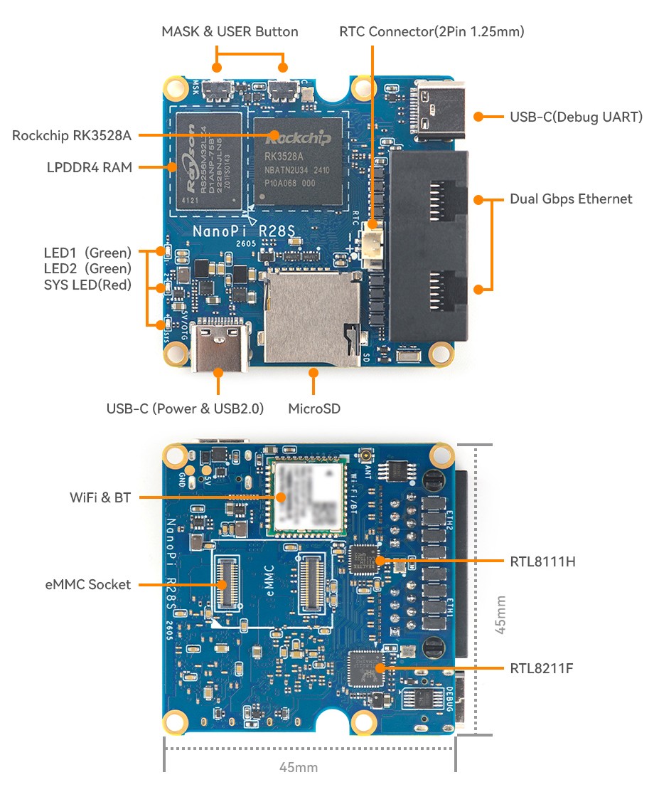

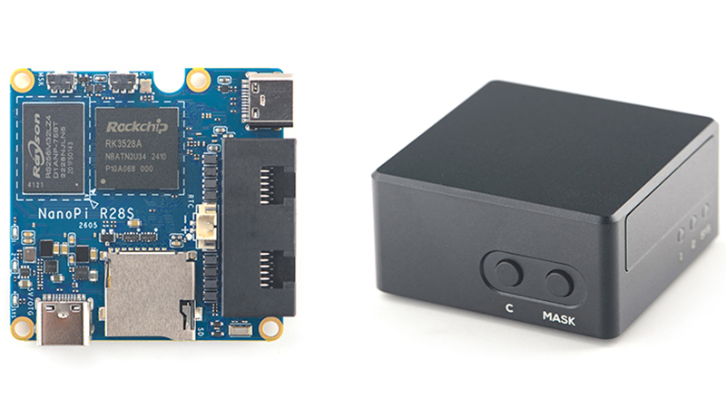

FriendlyElec has introduced the NanoPi R28S development board, a compact single-board computer built around the Rockchip RK3528A processor. The board combines a quad-core ARM Cortex-A53 CPU, Mali-450 GPU, 4K video decoding, dual Gigabit Ethernet, Wi-Fi 6, and Bluetooth 5.3 in a 45 × 45 mm PCB. With a starting price of $20, it targets low-cost networking, NAS, IoT, and embedded Linux projects.
The NanoPi R28S development board comes with 1GB of LPDDR4 RAM and supports external storage through a microSD card or optional eMMC module. Its compact design uses an 8-layer PCB and provides USB-C interfaces for power, eMMC upgrades, and UART debugging. The board also supports several Linux-based operating systems, giving developers flexibility for different applications.

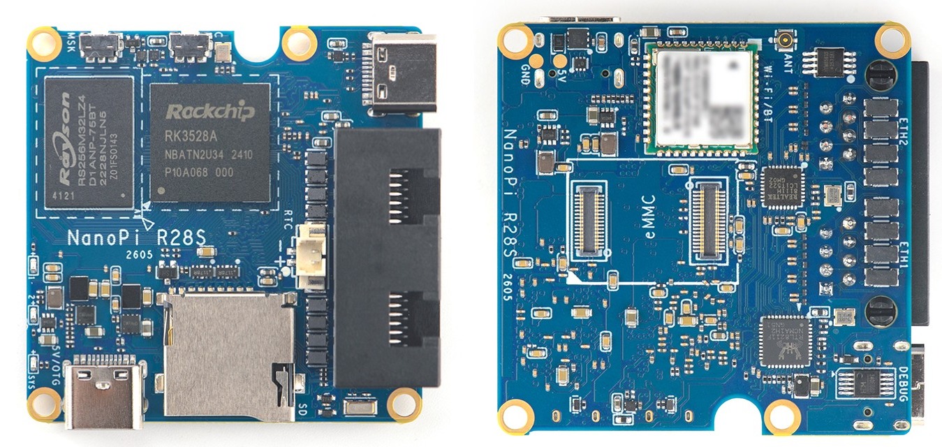

NanoPi R28S development board top and bottom side
NanoPi R28S Specifications:
  • Processor:
    • Rockchip RK3528A quad-core SoC
    • 4 × ARM Cortex-A53 cores
    • Clock speed up to 1.8GHz
  • Graphics and Video:
    • ARM Mali-450 GPU
    • 4K H.265/H.264 video decoding at up to 60fps
  • Memory and Storage:
    • 1GB LPDDR4 RAM
    • eMMC module support
    • 1 × microSD card slot
    • Supports microSD cards up to 128GB
  • Networking:
    • 2 × Gigabit Ethernet ports
    • RTL8211F and RTL8111H Ethernet controllers
    • Onboard Wi-Fi 6
    • Bluetooth 5.3
  • USB and Debugging:
    • 1 × USB-C 2.0 port for eMMC upgrades and 5V power input
    • 1 × USB-C port for UART debugging
  • Buttons and LEDs:
    • 1 × User/C button
    • 1 × MASK button for eMMC upgrades
    • 1 × red SYS LED
    • 2 × green user LEDs
  • RTC and Operating Conditions:
    • 2-pin 1.27/1.25mm RTC battery connector
    • HYM8563TS low-power RTC IC
    • Operating temperature from 0°C to 70°C
  • Power:
    • 5V/2A DC input
    • Non-PD power supply
  • Mechanical:
    • 8-layer PCB
    • 45 × 45 × 1.2mm board
    • Weight:
      • 14g without case
      • 77.5g with optional metal case

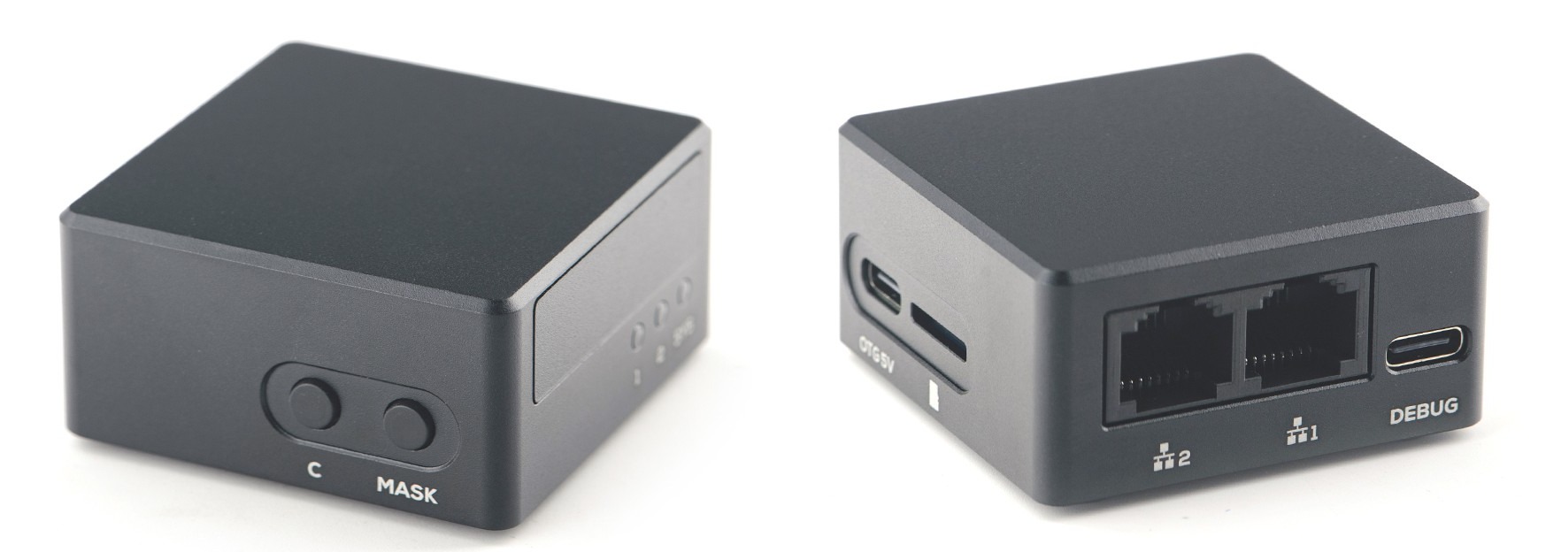

Metal case for NanoPi R28S development board
FriendlyElec lists the NanoPi R28S development board at $20 for the 1GB RAM bare-board version. Buyers can also choose a metal case for an additional $9, while optional 64GB and 256GB eMMC modules cost $34 and $78, respectively. A 32GB SanDisk Ultra microSD card costs $15.99.
