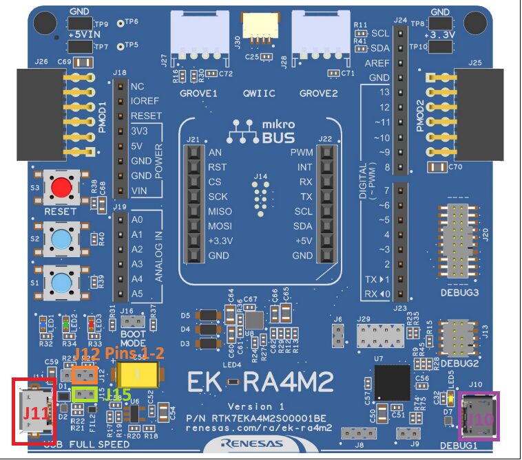

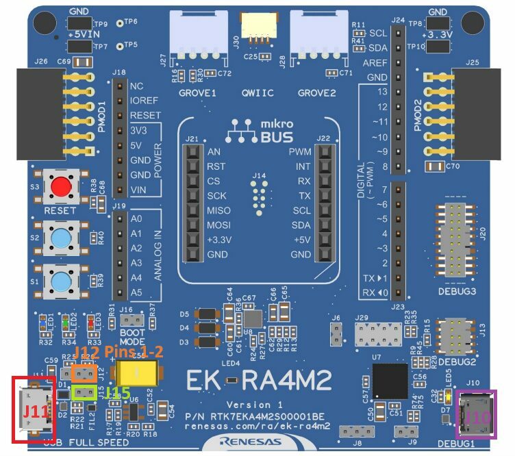

- Connect a Micro USB device cable (type-A male to micro-B male) between J10 (Debug1) and a Computer USB port.
- Plug in a BleuIO Dongle in the USB OTG Cable (type-A female to micro-B male) and connect it to J11 (USB Full Speed).
- Make sure Jumper J12 is placed on pins 1-2
- Remove Jumper J15 pins

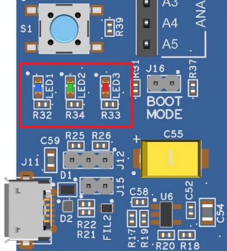

- The example will make us of the onboard LEDs R32 (Blue), R34 (Green), and R33 (Red):

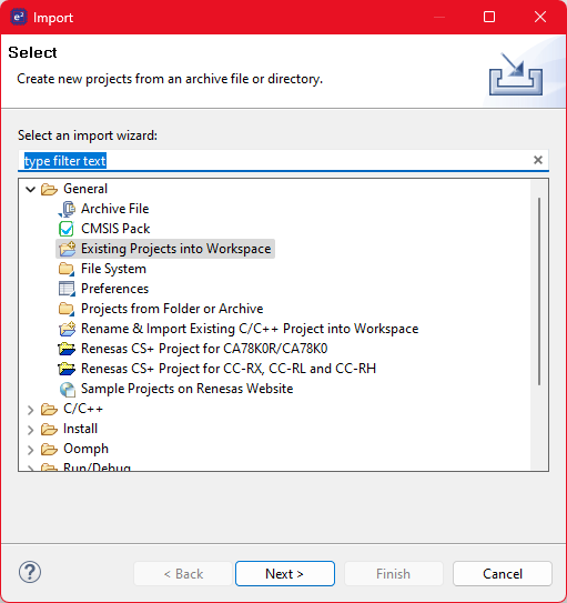

- Choose Import Project
- Select ‘Existing Projects into Workspace’ under the ‘General’ tab:

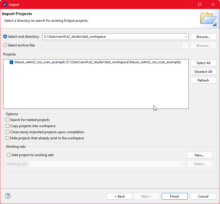

- Click the ‘Browse…’ button and open the folder where the ‘bleuio_ra4m2_co2_monitor_example’ project folder is located:
- Finally, select the project and click ‘Finish’. You have now imported the project!

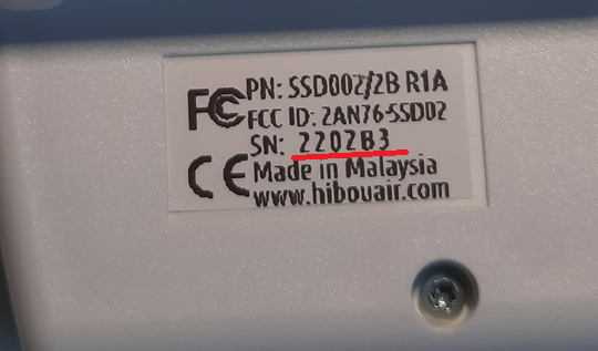

- Go to file ‘usb_hcdc_app.c’ under ‘src/’ and edit line 56 to the board ID of the HibouAir Sensor:
#define BOARD_ID_TO_SCAN "2202B3"
The board ID is printed on the back of the HibouAir sensor:

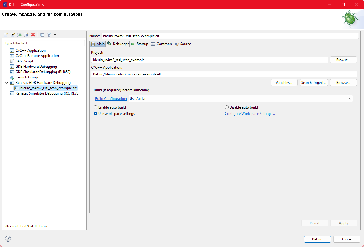

- Use Debug to download and run the project. The first time you need to configure the debug Click the down arrow to the right of the Debug icon and select ‘Debug Configurations…’
- Under ‘Renesas GDB Hardware Debugging’ select ‘bleuio_ra4m2_co2_monitor_example.elf’ and click ‘Debug’.
The debug is now configured and the ‘Debug’ icon can be used next time to run the project.

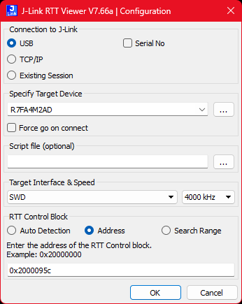

- Open Connect and use these settings: Connection to J-Link: USB
Specify Target Device: R7FA4M2AD Target Interface & Speed: SWD 4000kHz RTT Control Block: Address 0x2000095c
