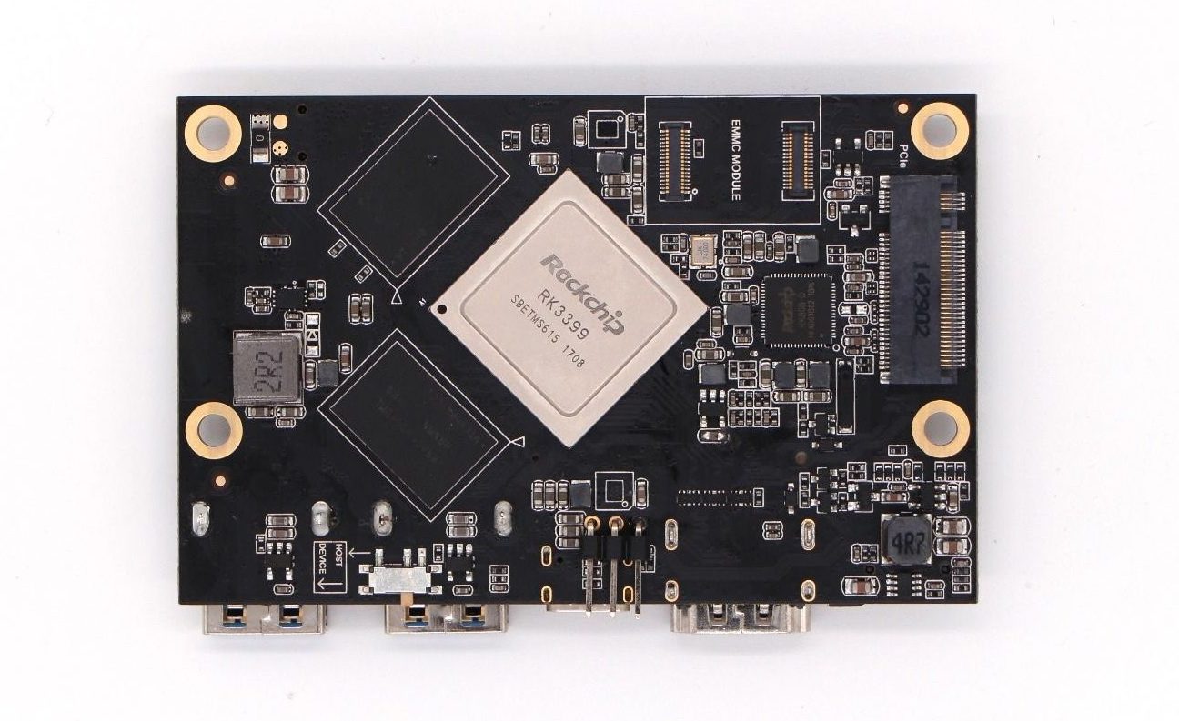

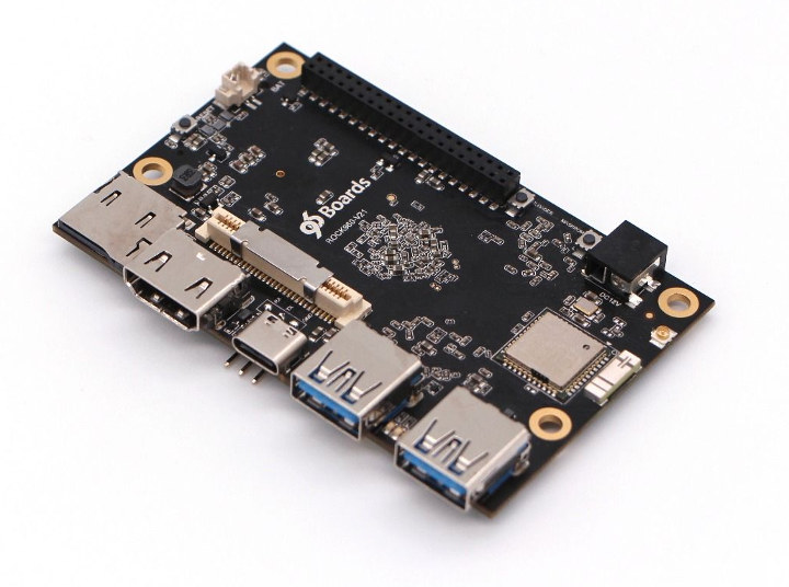

Rock960 Model C
Rock960 Model C
Rock960 model C is equipped with 1, 2 or 4GB LPDDR4 RAM, and the OS can boot from a micro SD card or an optional eMMC flash module. A good temptation might be to compare to the cheaper FriendlyElec NanoPi NEO4 board, although they offer similar specifications, the NanoPi NEO4 board is only available in a 1GB RAM alone. Also, it doesn’t have its own inbuilt storage, so microSD card is a must for running the OS.

Other changes, which have been made into new models are related to connectivity, memory, storage, USB ports. In connectivity, 2×2 MIMO has been downgraded. Type C USB ports are also replaced with USB 2.0. While USB 2.0 type-A port is upgraded to a USB 3.0 port. Thermal adaptations are also much better; a heatsink covers the bottom of the board. That provides a better cooling solution.
