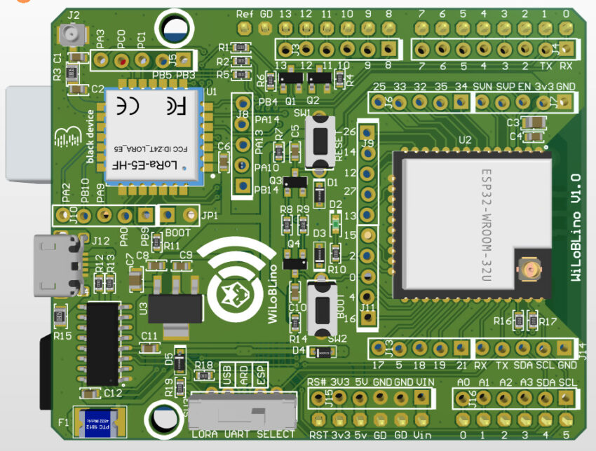

At the heart of the WiLoBLIno is the LoRa-E5 module integrated with STM32WLE5JC Arm Cortex-M4 low-power microcontroller and LoRa SX126X. The board is a compact and high-performance LoRa module designed for various IoT nodes, supporting EU868 and US915. Another onboard module is the ESP32-WROOM-32U which comes with an ESP32-D0WD chip with both the CPU cores that can be controlled individually, and the CPU clock frequency is adjustable from 80MHz to 240MHz.
Specifications of WiLoBLIno development board:
  • LoRa module: Seeed Studio LoRa-E5 wireless module
    • MCU: STM32WLE5JC with Arm Cortex-M4 processor core
    • LoRa: SX126X
    • Long distance use: 158dB link budget
    • Wireless connectivity: Embedded LoRaWAN protocol, AT command, support global LoRaWAN Frequency Plan
    • Serial communication: 3x UART, 1x I2C, 1x SPI
    • Modulation: LoRa, (G)FSK, (G)MSK, and BPSK
    • Power supply: 1.8V to 3.6V
    • Dimensions: 12x12x2.5 mm
  • ESP module: ESP32-WROOM-32U with ESP32-D0WD chip clocked up to a frequency of 240MHz
    • Wi-Fi: IEEE802.11b/g/n
    • Bluetooth: Bluetooth version 4.2 and Bluetooth Low Energy
    • Module interface: SD card, UART, SPI, I2C, LED PWM, Motor PWM, I2S, GPIO, ADC, DAC, etc.
    • Onboard sensor: Hall sensor
    • Storage: Integrated SPI flash of 4MB
    • Operating voltage: 3.0V to 3.6V
    • Operating temperature: -40°C to +85°C
    • Dimension: 18x19x2x3.2 mm
  • Power supply: 3V3 to 5V
  • Ports: USB Type-C for power supply and programming
