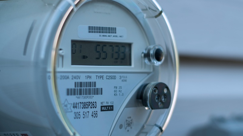

Utility metering, including smart electric meters, is one of the design wins named for the new LR2012 transceiver. Image used courtesy of Adobe Stock

All three share fourth-generation IP and Semtech’s Unified Software Platform, which the company positions against an installed base of more than 500 million LoRa devices. Metering vendors were among the early adopters of the sub-GHz part: Zenner selected the LR2012 for its Stealth Reader Meter Interface Unit for automated meter reading and infrastructure equipment, citing its LoRaWAN performance, OOK backward compatibility, and LR-FHSS support for satellite connectivity. Engelmann Sensor GmbH selected the LR2012 for its next-generation metering hardware, citing its price point and access to current LoRa capabilities.
