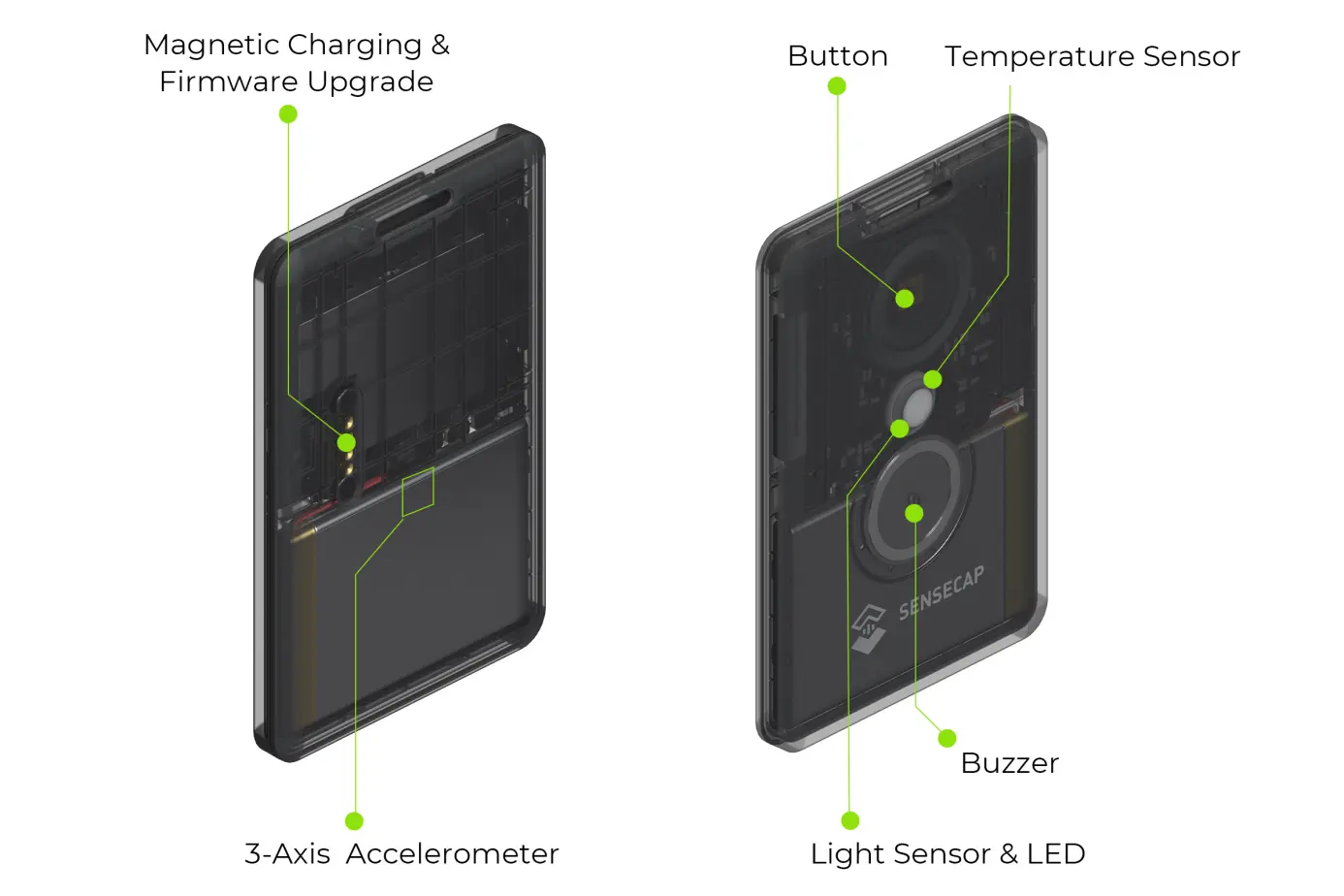

    • 1 LED and 1 buzzer for status alerts
    • 1 button for device operation

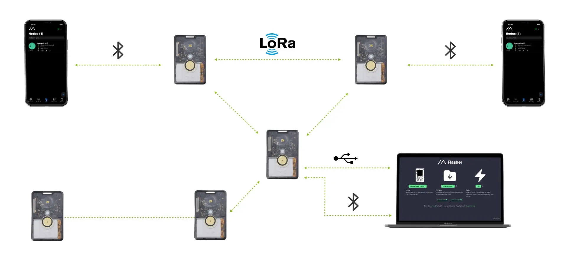

The T1000-E tracker features four pogo pins that support USB for DFU (Device Firmware Upgrade), serial logging, and API access, making device management and debugging easier. It is compatible with Meshtastic open-source firmware, which enables a decentralized mesh network for long-range, low-power messaging and GPS sharing. Meshtastic uses LoRa radios to provide off-grid communication in areas without infrastructure, offering encrypted messaging without the need for routers or phones. The Meshtastic app is available on Android and iOS. More information about the product can be found on the Seed Studios Wiki Page.
