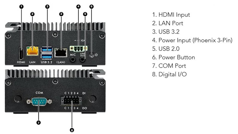

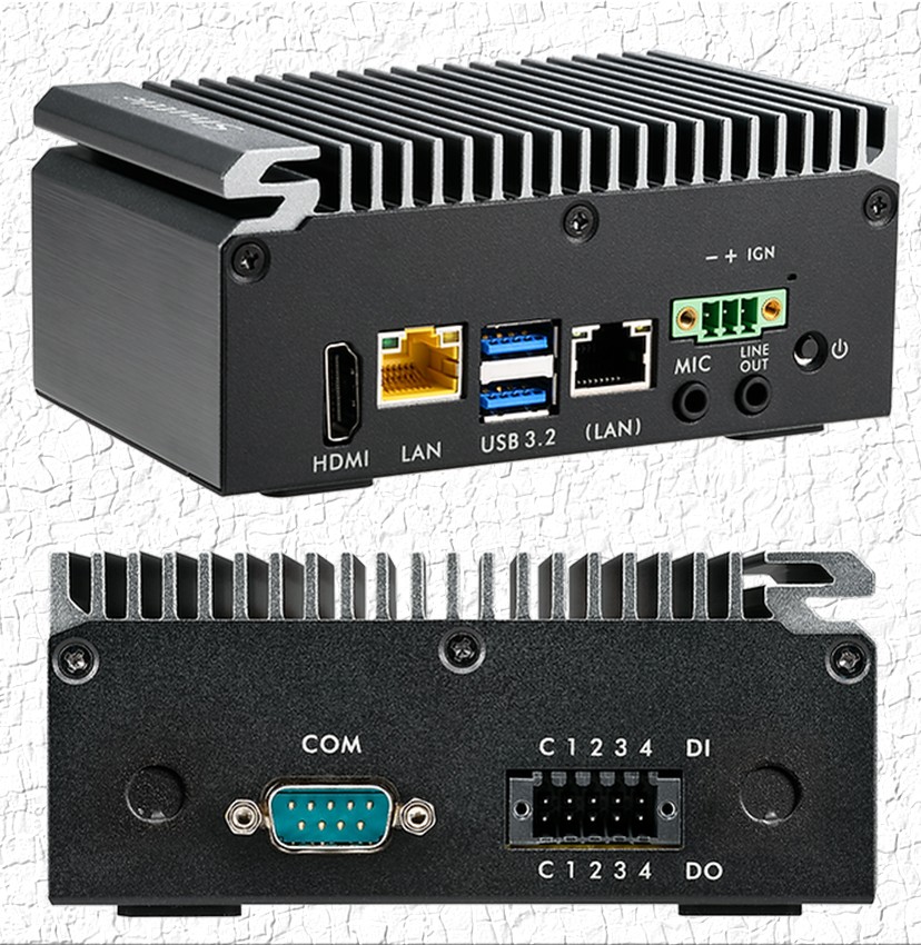

Shuttle SPCNV03 Industrial Edge AI PC Front And Back

Shuttle SPCNV03 Front and Rear View Spec
