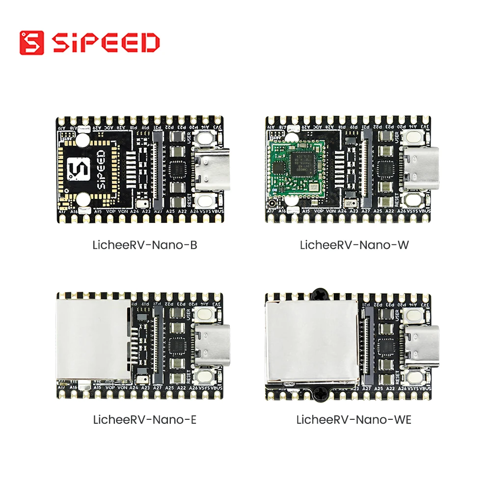

Sipeed LicheeRV Nano Specifications:
  • Version Variants:
    • LicheeRV-Nano-B: Basic system with microphone/speaker.
    • LicheeRV-Nano-E: Adds Ethernet.
    • LicheeRV-Nano-W: Adds WiFi6/BT5.
    • LicheeRV-Nano-WE: Includes microphone/speaker, Ethernet, and WiFi6/BT5.
  • CPU: SOPHGO SG2002; selectable major core (1GHz RISC-V C906 or ARM A53) and a minor 700MHz RISC-V C906 core; low-power 25~300MHz 8051 core.
  • NPU: 1TOPS INT8, supports BF16.
  • Memory: Integrated 2Gbit (256MB) DDR3.
  • Storage: Bootable from TF card or SD NAND (SD NAND pads under TF card slot).
  • Video Interface:
    • Output: 2-lane MIPI DSI, supports 6-pin capacitive touchscreen.
    • Input: 4-lane MIPI CSI, supports dual CSI split.
  • Audio Interface:
    • Output: Onboard PA amplifier for <1W speakers.
    • Input: Onboard analog silicon microphone.
  • Connectivity:
    • Wired: 100M RJ45 connector (E suffix version).
    • Wireless: 2.4G/5.8G dual-band WiFi6 + BLE5.4 (W suffix version).
  • USB: 1x USB2.0 OTG Type-C.
  • I/O Interface: 2x 14-pin 2.54mm pin headers, breadboard-friendly.
  • Controls: 1x RST button, 1x BOOT button.
  • Indicators: 1x Power LED, 1x User LED.
  • Operating System: Buildroot Linux / Debian.
  • Dimensions: 22.86×35.56mm.
