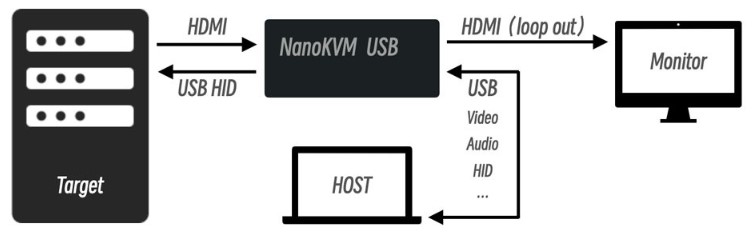

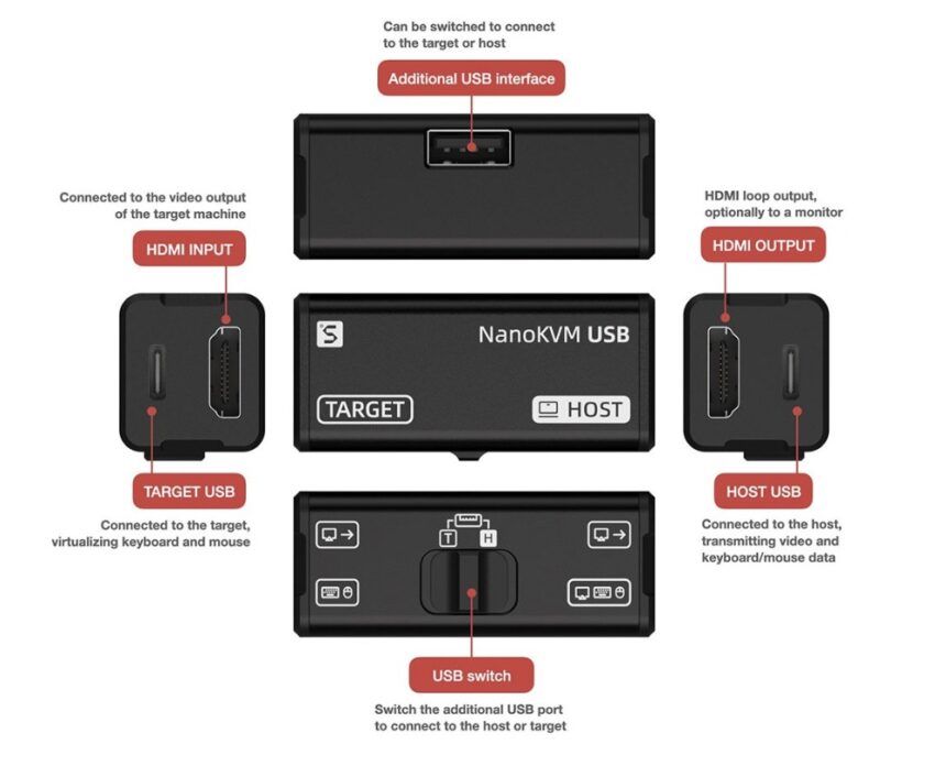

  • Video I/O Resolution:
    • HDMI Input: Supports 4K @ 30fps
    • HDMI Loopback Output: Supports 4K @ 30fps
  • USB Interfaces:
    • Type-C USB 3.0 Port: For connection to PC, enabling keyboard/mouse emulation
    • Type-A USB 2.0 Port: For switching between TARGET or HOST devices
  • USB Capture:
    • Supports 1080P @ 60fps
    • Supports 2K @ 30fps
  • Miscellaneous:
    • USB Switch functionality
    • Latency: 50-100ms
  • Dimensions: 57 mm x 25 mm x 23 mm
To use the NanoKVM-USB device, users must visit the designated website using Google Chrome, as Mobile Chrome lacks support for the Web Serial API, which is required for keyboard and mouse functionality. After granting authorization, users need to select two USB devices: the USB Camera for transmitting video and audio data and the Serial Device for sending keyboard and mouse data, completing the setup process.
The NanoKVM-USB features an aluminum alloy shell and is available in black, blue, and red color options. It can be pre-ordered on the Sipeed website at $39.9 or $49.9 per unit, excluding shipping costs and additional fees. The package includes one USB cable and two USB-C cables. The product will also be launched soon on AliExpress and the official Taobao store. For more details, users can visit the wiki page and the pre-sales page.
