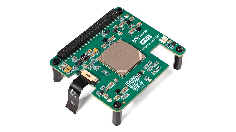

Sixfab AI HAT+ top view
Sixfab AI HAT+ Specifications:
  • Host SBC: Raspberry Pi 5
  • AI Acceleration Options:
    • DEEPX DX-M1M: Up to 25 TOPS (INT8) with 2 GB LPDDR4X memory
    • DEEPX DX-M1ML: Up to 13 TOPS (INT8) with 1 GB LPDDR4X memory
  • Interface: PCIe Gen 3 x1 via 16-pin FFC cable
  • Power:
    • Supply: 5V / 3A via the Raspberry Pi 5 40-pin GPIO header (27W PSU recommended; standard 15W is insufficient)
    • Consumption: ~3W NPU peak draw (~13–15W combined Pi 5 + HAT+ under full load)
  • Cooling: Passive by default; includes an onboard 2-pin JST connector for an optional fan
  • Form Factor: Raspberry Pi HAT+ compliant (65 x 56.5 x 6.56 mm)
  • Operating Temperature: 0°C to 70°C (Commercial grade)

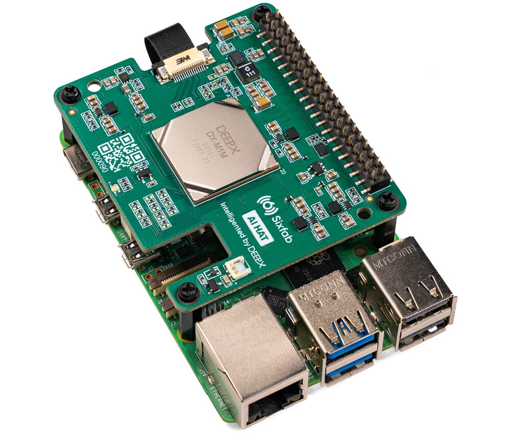

Sixfab AI HAT+ installed on Raspeberry 5
On the software side, the board follows the Raspberry Pi HAT+ standard and uses EEPROM for automatic setup. It works on Raspberry Pi OS with a runtime package (dxrt-runtime). Pre-built models like YOLOv8, MobileNet, and ResNet can be used, and custom models can be converted using ONNX and compiled with the DEEPX toolchain. It supports both Python and C++ for development.
The AI HAT+ is designed for computer vision tasks and is similar in performance to the Hailo-8 AI HAT+, but it is not suitable for running generative AI or large language models due to hardware limitations. Support for such workloads may be added in future versions of the DEEPX chips.
