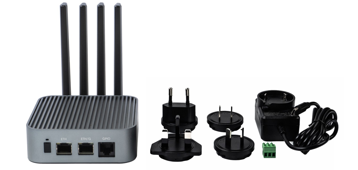

ALPON X4 is an industrial and IoT-oriented edge computer from the Raspberry Pi Compute Module 4 (CM4). It's used for processing data, remote monitoring, and automation in rugged environments.
ALPON X4 CM4 edge computer
ALPON X4 is an industrial and IoT-oriented edge computer from the Raspberry Pi Compute Module 4 (CM4). It’s used for processing data, remote monitoring, and automation in rugged environments. It utilizes a fanless aluminum housing for passive cooling and increased durability.
It provides multiple connectivity scenarios, such as Ethernet, Wi-Fi, LTE, and eSIM-based network switching for reliable global communication. Security is managed with TPM 2.0 for hardware-assisted encryption and secure communication. Remote device management, firmware updates, monitoring, and bulk provisioning are facilitated through ALPON Cloud integration. The ALPON X4 is appropriate for industrial automation, real-time monitoring systems, and edge AI scenarios, giving a scalable hardware-software platform for connected deployments.

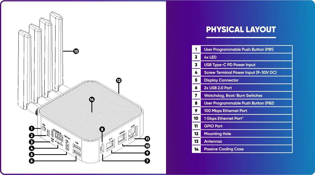

ALPON X4 specifications:
  • SoM: Raspberry Pi Compute Module 4 (CM4)
    • SoC: Broadcom BCM2711 quad-core Cortex-A72 @ 1.5GHz
    • GPU: VideoCore VI with OpenGL ES 3.1 and Vulkan 1.0 support
    • VPU:
      • Decode: H.265/HEVC up to 4Kp60, H.264 up to 1080p60
      • Encode: H.264 up to 1080p30
    • Memory: 8GB LPDDR4-3200 (optional 2GB or 4GB)
    • Storage: 32GB eMMC flash (optional 8GB or 16GB)
    • Optional wireless module with dual-band Wi-Fi 5 and Bluetooth 5.0
  • Video Output: HDMI
  • Connectivity:
    • 1x Gigabit Ethernet RJ45 port
    • 1x 10/100Mbps Ethernet RJ45 port
    • Cat4 LTE support with eSIM auto network switching
    • 4x external antenna connectors
  • USB: 2x USB 2.0 Type-A ports
  • Security: TPM 2.0 for secure operation
  • Expansion: RJ11 GPIO port
  • Misc:
    • 2x user push-buttons
    • 4x LEDs
    • Watchdog and Boot-Burn switches
  • Power Input:
    • USB-PD via USB Type-C
    • 9-30V DC via screw terminal block
    • Optional PoE+ (IEEE 802.3at)
  • Dimensions: 111.16 x 99.9 x 33 mm (without antennas)
  • Operating Temperature: -20°C to +60°C
  • Certification: CE, FCC, IC, UKCA, ICASA (in progress), RCM, RoHS, WEEE, REACH

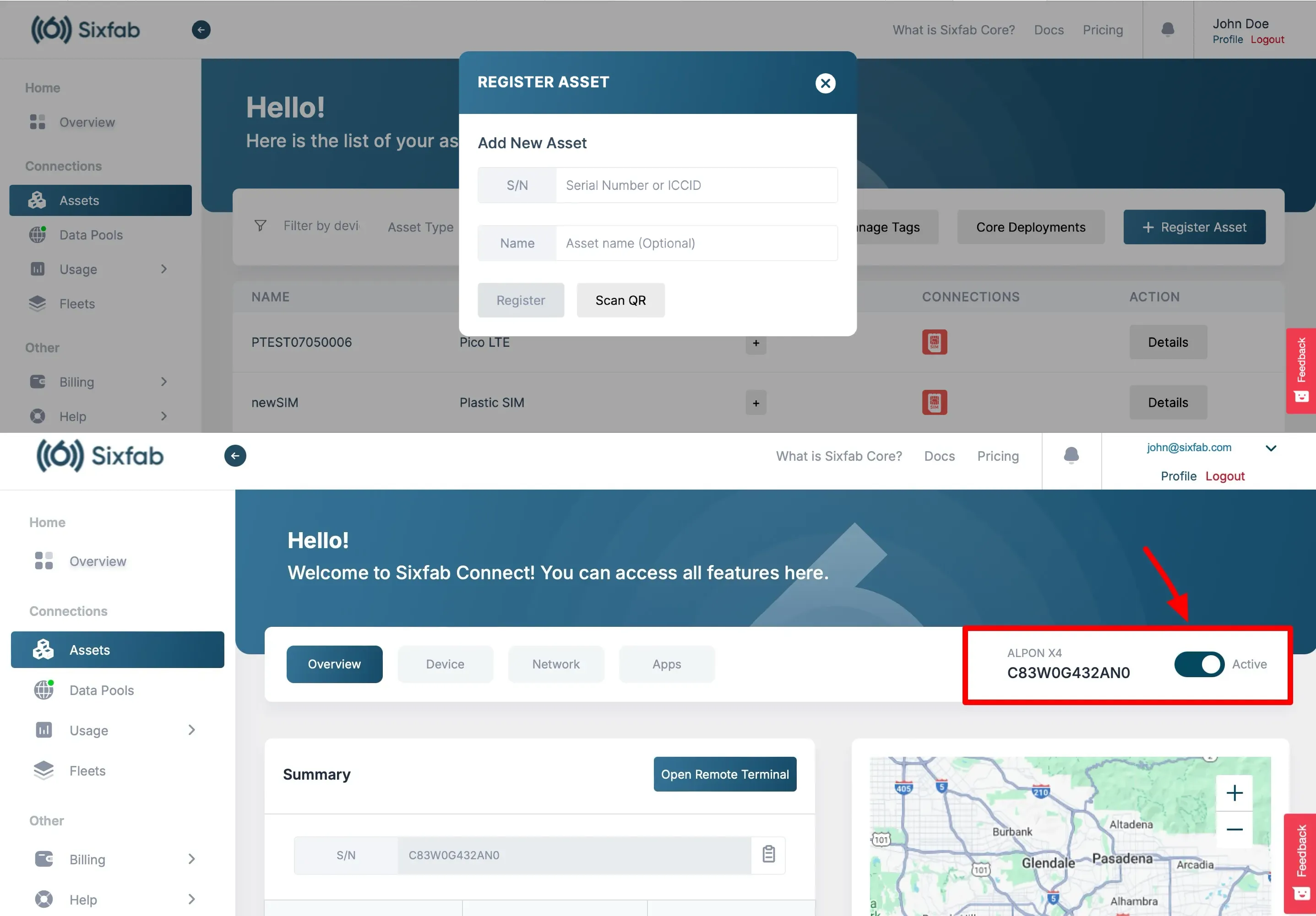

The ALPON X4 can be registered by scanning the QR code on the device for automatic setup or manually through the Sixfab Connect platform, securely linking the device to the user account.
