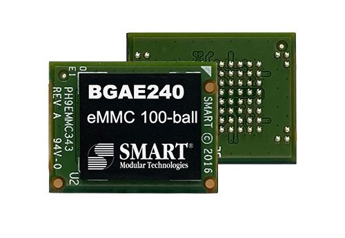

SMART Modular Technologies DuraFlash™ BGAE240 eMMC Memory is an industrial-grade embedded memory solution in a compact BGA (Ball Grid Array) package. The BGAE240 integrates 2D-MLC NAND Flash Memory, an embedded MMC (MultiMediaCard) controller, and advanced firmware into a single unit that provides stable, cost-effective, and high-density embedded storage.
SMART Modular Technologies DuraFlash™ BGAE240 eMMC Memory is an industrial-grade embedded memory solution in a compact BGA (Ball Grid Array) package. The BGAE240 integrates 2D-MLC NAND Flash Memory, an embedded MMC (MultiMediaCard) controller, and advanced firmware into a single unit that provides stable, cost-effective, and high-density embedded storage. BGAE240 eMMC Memory is designed to meet the rigid requirements of the industrial, medical, and networking markets where technical support, extended life, and stable roadmaps are critical.
The SMART Modular Technologies DuraFlash BGAE240 eMMC Memory Modules are offered in capacities from 8GB to 64GB and are compliant with the JEDEC® v5.0 standard.
  • Capacities from 8GB to 64GB
  • Up to 270MB/s read
  • Up to 95MB/s write
  • Compliant to JEDEC v5.0 standard
  • Pre-configurable to pSLC enhanced storage media mode
  • VCC = 3.3V and VCCQ = 3.3V or 1.8V
Specifications
  • Performance
    • eMMC v5.0 host interface
    • 270MB/s maximum sequential read
    • 95MB/s maximum sequential write
    • 5.3K IOPS random read
    • 1.2K IOPS random write
  • Reliability
    • 10-year data retention
    • BCH error correction
  • Power
    • 3.3V ±5% input voltage
  • Environmental and physical
    • Operating shock
      • 1500g half-sine, 0.5msec
      • 1 shock along each axis
      • X, Y, Z in each direction
    • Operating vibration
      • 20G 80Hz to 2000Hz
      • 1.52mm 20Hz to 80Hz, 3 axis
    • Industrial -40°C to +85°C operating temperature range
    • 11.5mm x 13.0mm x 1.0mm BGA153 package
