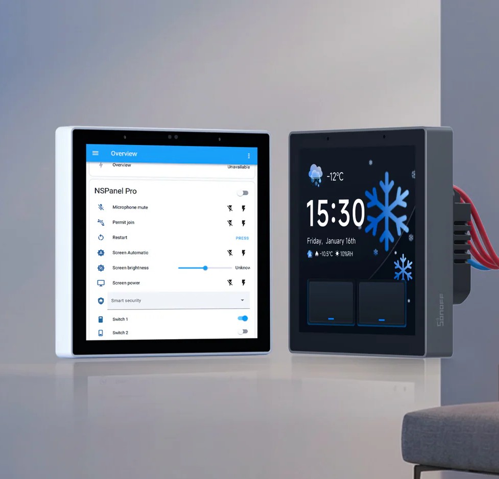

SONOFF has launched the NSPanel Pro Gen2, an 86-type Smart Home control panel designed for centralized device management, automation, and home monitoring. The panel combines a 3.95-inch capacitive touchscreen, dual-channel relay control, and support for Zigbee 3.0, Matter, dual-band WiFi, and Bluetooth connectivity.
The device targets users who want a wall-mounted smart home dashboard with local relay control and compatibility with ecosystems such as Home Assistant, Google Home, Amazon Alexa, and Apple Home. SONOFF also upgraded the hardware compared to the previous NSPanel Pro model by adding a newer Rockchip RK3326-S processor, 32GB eMMC storage, dual-band WiFi support, and a louder 1.5W speaker.

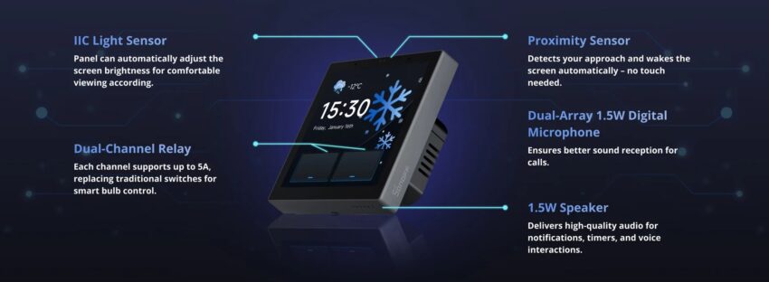

Features of the SONOFF NSPanel Pro Gen2:
  • SoC: Rockchip RK3326-S processor
  • CPU: Quad-core Arm Cortex-A35 processor @ up to 1.5GHz
  • GPU: Arm Mali-G31-2EE GPU
  • Memory: 2GB RAM
  • Storage: 32GB eMMC flash
  • Display: 3.95-inch capacitive multi-touch TFT display with 480 × 480 resolution
  • Wireless Connectivity: IEEE 802.11a/b/g/n/ac/ax dual-band WiFi (2.4GHz/5GHz), Zigbee 3.0, Bluetooth LE
  • Zigbee MCU: Silicon Labs EFR32MG24
  • Matter Support: Built-in Matter bridge for cross-platform smart home integration
  • Relay: Dual-channel relay supporting up to 5A per channel or 10A total resistive load
  • Audio: 1.5W speaker and dual-array digital microphone
  • Sensors: Ambient light sensor and proximity sensor
  • Smart Home Features: Zigbee gateway, Zigbee router mode, Home Assistant dashboard support, smart thermostat, camera monitoring, security modes
  • Power Input: 100–240V AC, 50/60Hz
  • Operating Temperature: -10°C to 40°C
  • Operating Humidity: 10% to 80% RH (non-condensing)
  • Dimensions: 86 × 86 × 39.5 mm
  • Weight: 190g
  • Certification: CE, RoHS

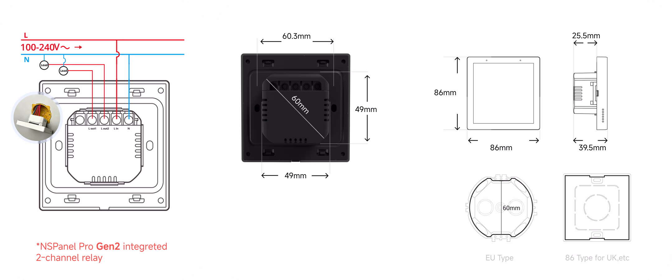

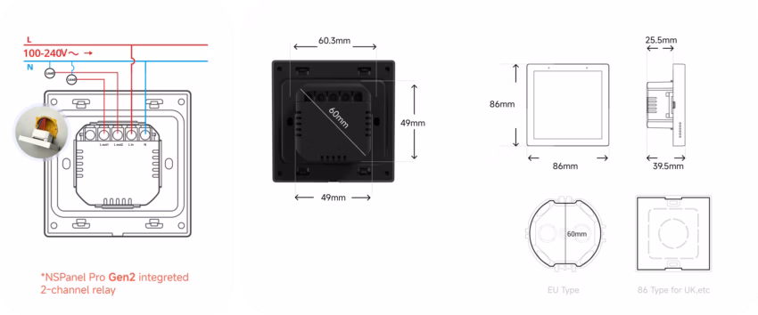

Wiring Diagram
Wiring Diagram
