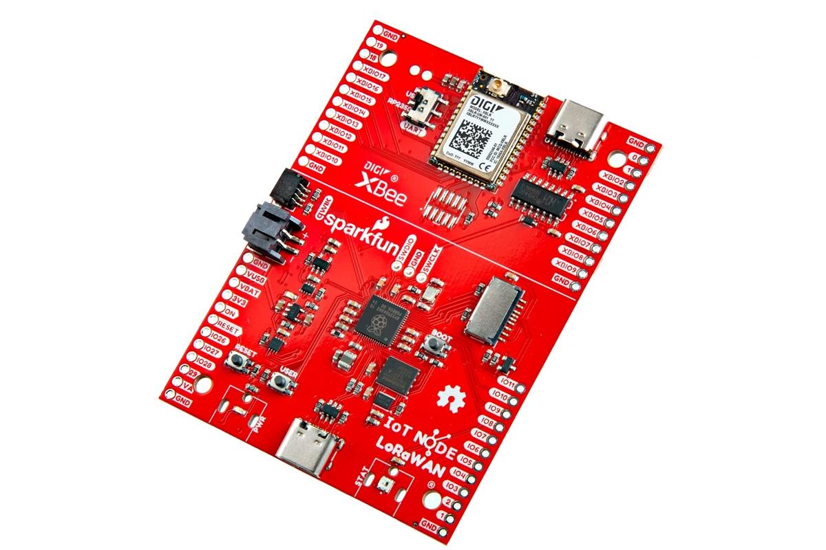

Specifications of SparkFuns IoT Node for LoRaWAN
  • SoC: Raspberry Pi RP2350A
    • Dual-core Cortex-M33 @ 150 MHz with Arm TrustZone
    • Dual-core 32-bit Hazard3 RISC-V @ 150 MHz
    • Up to two cores can run simultaneously
  • Memory: 520KB SRAM, 8kB OTP storage
  • Storage: 16MB QSPI flash, microSD card slot
  • Connectivity
    • LoRaWAN: Digi XBee LR Module
      • Frequency range: 902-928 MHz (US), 868-870 MHz (EU)
      • FCC & IC certified
  • USB: USB Type-C for power & programming
  • Expansion
    • 15 multifunction GPIOs
    • Up to 8x 2-channel PWMs
    • Up to 2x UARTs, 2x I2C buses, 2x SPI buses
  • Misc
    • Reset, Boot, and User buttons
    • PWR (red) – 3.3V power indicator
    • CHG (yellow) – battery charging indicator
  • Power:
    • 2-pin JST connector for LiPo battery (not included)
    • USB-C (5V input)
    • LiPo charger (MCP73831, 500mA charge rate)
    • Fuel gauge (MAX17048)
  • Dimensions: 83mm x 59mm

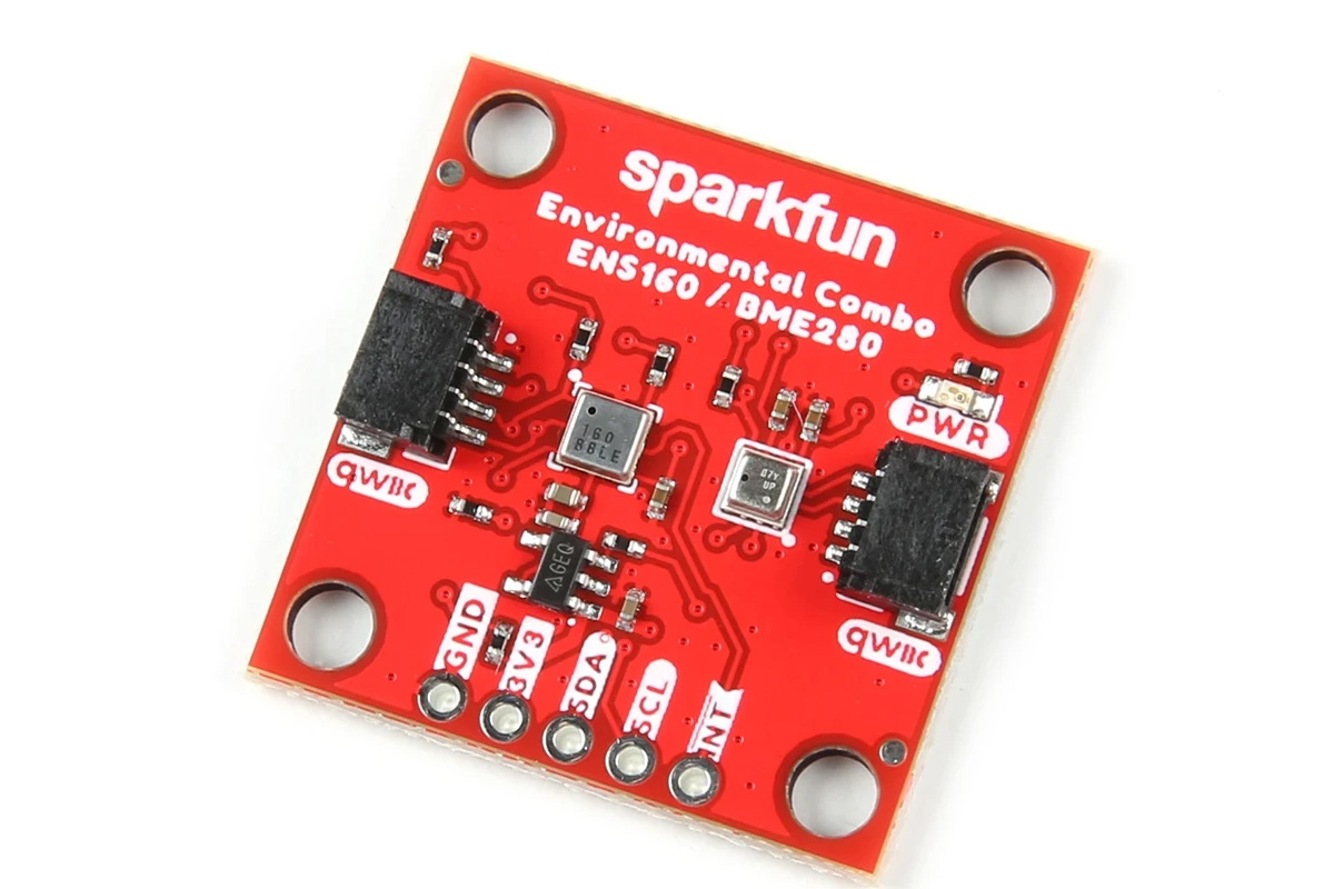

SparkFun ENS160/BME280 Environmental Sensor Module Specifications
  • ENS160 (Air Quality Sensor):
    • Air Quality Index (AQI) – Umweltbundesamt (UBA) standard
    • eCO2 range: 400 to 65,000 ppm, resolution 1 ppm
    • TVOC range: 0 to 65,000 ppb, resolution 1 ppb
    • Humidity and ozone compensation
    • Independent sensor heater control
    • I²C Address: 0x53 (default) or 0x52
  • BME280 (Temperature, Humidity, Pressure Sensor):
    • Temperature:
      • Range: -40°C to 85°C, Accuracy: ±0.5°C (0°C to 65°C), Resolution: 0.01°C
    • Humidity:
      • Range: 0% to 100% RH, Accuracy: ±3% (20% to 80% RH), Resolution: 0.008% RH
    • Pressure:
      • Range: 30,000 Pa to 110,000 Pa, Absolute accuracy: ±100 Pa, Relative accuracy: ±12 Pa, Resolution: 0.18 Pa
      • Altitude Estimation: ±1m at sea level, ±2m at 30,000ft
      • I²C Address: 0x77 (default) or 0x76
  • Connectivity:
    • 2x Qwiic connectors (I²C interface)
    • 0.1-inch header pins for alternative connection
  • Misc:
    • Power LED
    • I²C pull-up resistors (2.2kΩ)
    • Selectable I²C addresses via jumpers
  • Power Supply:
    • Input voltage – 3.3V via Qwiic cable
    • ENS160 operating voltage – 1.71V to 1.98V
    • BME280 operating voltage – 1.71V to 3.6V
    • Onboard 1.8V AP2127K voltage regulator for ENS160
  • Dimensions: 1.0 x 1.0 inches (25.4 x 25.4 mm)
  • Weight: 2.50g

SparkFun IoT Node for LoRaWAN board
ENS160 and BME280 Environmental Sensor Combo
