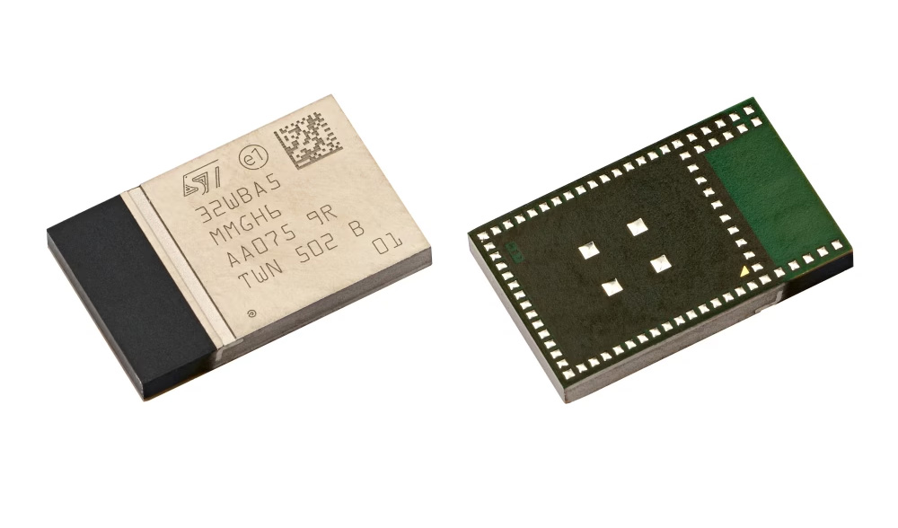

The STMicroelectronics STM32WBA5MMG is a compact (12.5 x 8 mm), ultra-low-power wireless module with support for Bluetooth LE 6.0, Zigbee 3.0, and OpenThread protocols, making it suitable for IoT, smart home, healthcare, industrial, and wearable applications. Based on the STM32WBA55UG microcontroller and designed for applications for IoT, smart home, healthcare, industrial, and wearable applications.
Key features include an Arm Cortex-M33 CPU with TrustZone, 1MB Flash with ECC, 128KB SRAM, and more. Security features include hardware encryption, secure firmware installation, tamper detection, and cryptographic accelerators. The module integrates an antenna (or supports external), supports up to +10 dBm Tx power, and features high-sensitivity receivers for robust wireless communication. On top of that, it requires no RF expertise for board integration and works with 2-layer PCBs to reduce costs. These features make this suitable for developers needing a compact, power-efficient wireless solution with rich protocol support and security features.

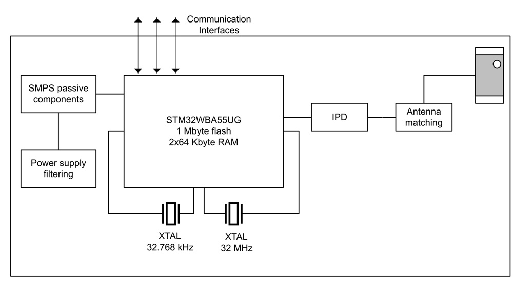

STM32WBA5MMG Wireless MCU Module Specifications:
  • MCU: STM32WBA55UG with Arm Cortex-M33 core @ 100 MHz with TrustZone®, MPU, DSP, and FPU
  • Memory:
    • 1MB Flash with ECC (256KB with 100k write cycles)
    • 128KB SRAM (64KB with parity check)
    • 512B OTP (32 rows)
    • 8KB instruction cache with ART Accelerator
  • Wireless connectivity:
    • Bluetooth LE 5.4 (LE 2M, LE coded PHY, direction finding, LE audio, extended/periodic advertising)
    • IEEE 802.15.4 for Zigbee, Thread, and proprietary protocols
    • Supports dynamic and static concurrent modes
  • RF performance:
    • Tx power: Up to +10 dBm (1 dB steps)
    • Rx sensitivity: -96 dBm (BLE @ 1 Mbps), -97.5 dBm (802.15.4 @ 250 kbps)
  • Antenna:
    • Integrated antenna with IPD (matching circuit)
    • Optional external antenna support
  • Power:
    • Supply voltage: 1.71V to 3.6V
    • Integrated SMPS
    • Ultra-low-power modes for battery-powered applications
  • I/Os:
    • Up to 33 general-purpose I/Os (most 5V-tolerant)
    • Interrupt capability
  • Security:
    • Secure firmware installation (SFI)
    • AES hardware accelerator, HASH engine, public key accelerator (PKA)
    • True random number generator (TRNG)
    • Flash readout protection (RDP), hide protection (HDP)
    • Tamper detection
    • Root hardware unique key (RHUK), 96-bit UID
  • Clocks: Integrated 32 MHz and 32 kHz crystals (only one external capacitor required)
  • Debug: SWD and JTAG supported
  • Certifications: CE, FCC, ISED, MIC, RoHS, REACH
    • Planned: KC, NCC, SRRC, ANATEL
  • Temperature: -40°C to +85°C
  • PCB compatibility: Suitable for 2-layer PCB designs
  • Package: SiP-LGA76 (12.5 x 8 mm)

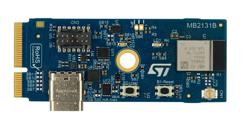

The easiest way to get started with the STM32WBA5MMG module is by using the B-WBA5M-WPAN connectivity expansion board, which integrates the wireless module and adds several useful features. It includes a 256 Kbit serial I2C EEPROM for storage and a set of MEMS sensors, such as a high-accuracy temperature sensor, a 3D accelerometer, and a 3D gyroscope. The board offers an M.2 E-Key connector for host interface, supporting UART, SPI, I2C, and SAI interfaces along with power signals. For development and debugging, it provides an STDC14 debug connector (CN3) compatible with the STLINK-V3SET debugger. Additional features include a user LED, user and reset push buttons, and flexible power supply options via USB Type-C or through the M.2 E-Key connector.
