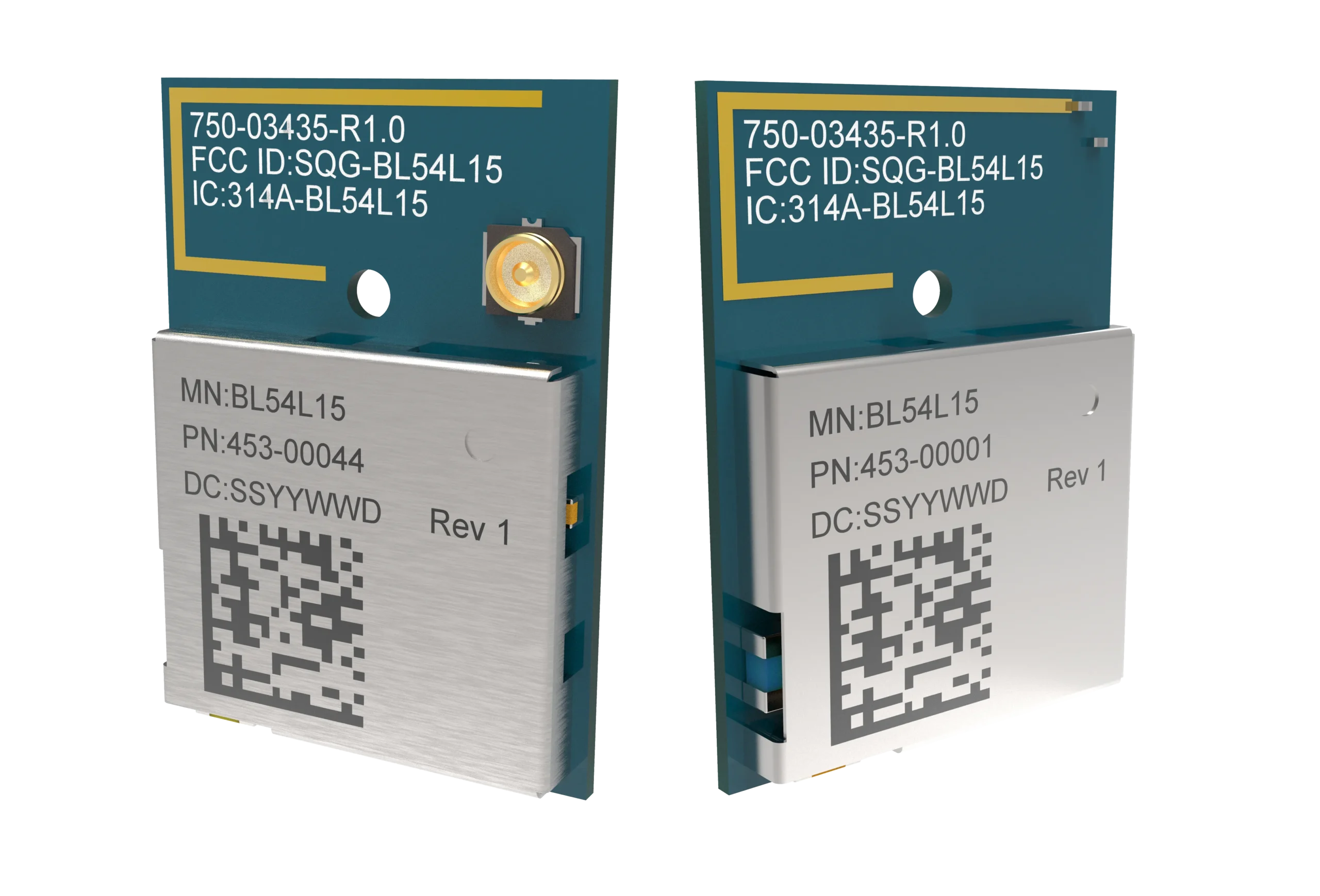

The BL54L15 series, using Nordic’s nRF54L15 SoC, improves on the nRF52 series with more power and memory. The module features a 128MHz ARM Cortex M33 and RISC-V coprocessor, 1.5 MB memory, and 256 KB RAM, doubling the power of the previous BL654 series. It supports Bluetooth LE, 802.15.4, and NFC A-Tag, and focuses on security with Secure Boot and Firmware Update, aiming for PSA Certified level 3.
The BL54H20 series features the Nordic nRF54H20 SoC with a multi-core MCU, including 2x ARM Cortex-M33 and 2x RISC-V coprocessors, 2MB non-volatile memory, and 1MB RAM. It supports Bluetooth LE 5.4, LE Audio, Bluetooth Mesh, 802.15.4, Thread, and Matter. The compact BL54L15 measures 14 mm x 10 mm x 1.6 mm. Designed for security with PSA Certified level 3, it includes tamper sensors, Secure Boot, and Firmware Update, and works in temperatures from -40 to 105°C.
The BL54L15 and BL54H20 series support development with the Canvas Software Suite, Nordic SDK, or Zephyr RTOS. They allow for easy firmware updates over the air using MCUboot and Zephyr. Thanks to their multi-core MCU setup, these modules can work without a host, cutting down costs. Both series are in the process of getting international certifications for worldwide use.

  • Leverages Nordic Semiconductor’s nRF54 silicon: Enhances wireless capabilities with support for Bluetooth LE 5.4, 802.15.4, and NFC.
  • Compatibility with Zephyr RTOS and Nordic nRF Connect SDK: Broadens the application scope in advanced wireless solutions.
  • BL54L15 Series:
    • Powered by Nordic’s nRF54L15 SoC for superior processing power and expanded memory.
    • Equipped with a 128MHz ARM Cortex M33 and a 128MHz RISC-V coprocessor.
    • 1.5 MB non-volatile memory and 256 KB RAM, offering double the processing power of the previous nRF52840-based BL654 series.
    • Supports robust Bluetooth LE, 802.15.4 with NFC A-Tag implementation.
    • Emphasizes security with features like Secure Boot and Secure Firmware Update, aiming for PSA Certified level 3.
  • BL54H20 Series:
    • Features Nordic nRF54H20 SoC with a multi-core MCU architecture.
    • Integrates 2x ARM Cortex-M33 and 2x RISC-V coprocessors for workload optimization.
    • Boasts 2MB of non-volatile memory and 1MB of RAM.
    • Supports Bluetooth LE 5.4, LE Audio, Bluetooth Mesh, and 802.15.4 protocols including Thread and Matter.
    • Designed for PSA Certified level 3 with integrated tamper sensors.
    • Operates within a wide temperature range (-40 to 105°C).
  • Development Versatility: Supports Canvas Software Suite, Nordic SDK, or Zephyr RTOS with FOTA updates via MCUboot and Zephyr.
  • Multi-Core MCU Design: Enables hostless operation, reducing costs.
  • Pending International Certifications: Ensures global compliance.
  • Early Sample Availability: Invites customers to reach out for early samples for both BL54H20 and BL54L15 series.
