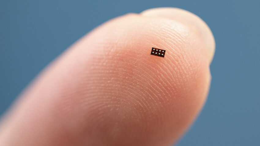

Texas Instruments has announced what it claims to be the world’s smallest microcontroller, the MSPM0C1104, which measures 1.38 mm²—approximately the size of a black pepper flake. This microcontroller is part of the MSPM0 series, built on the 32-bit Arm Cortex-M0+ CPU architecture.
Texas Instruments MSPM0C1104
Texas Instruments has announced what it claims to be the world’s smallest microcontroller, the MSPM0C1104, which measures 1.38 mm²—approximately the size of a black pepper flake. This microcontroller is part of the MSPM0 series, built on the 32-bit Arm Cortex-M0+ CPU architecture. Among the three variants in the MSPM0 lineup, the MSPM0C serves as the entry-level option, featuring a 24 MHz clock and 8-16 kB of flash memory, and is available in ultra-compact packaging.
The MSPM0 family was initially designed to extend Texas Instruments’ 16-bit MSP430 line by providing a larger address space for both code and data while maintaining low power consumption and integrating essential peripheral devices. The introduction of the MSPM0C1104 MCU specifically addresses the growing need to minimize board space in compact applications, such as medical wearables and personal electronics.
