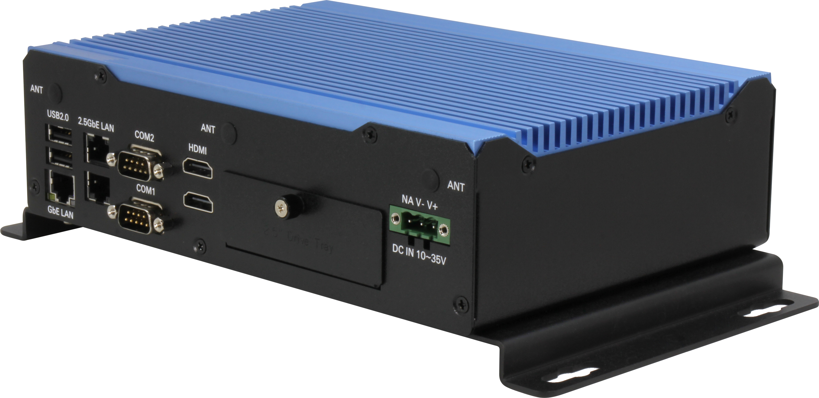

Leading provider of industrial PC solutions AAEON, has introduced the BOXER-6647-MTH, a fanless embedded computer powered by the Intel® Core Ultra platform. Available with either the Intel® Core Ultra 7 processor 155H or Intel® Core Ultra 5 processor 125H, the BOXER-6647-MTH sports a wide variety of interfaces tailored for industrial robotics use.

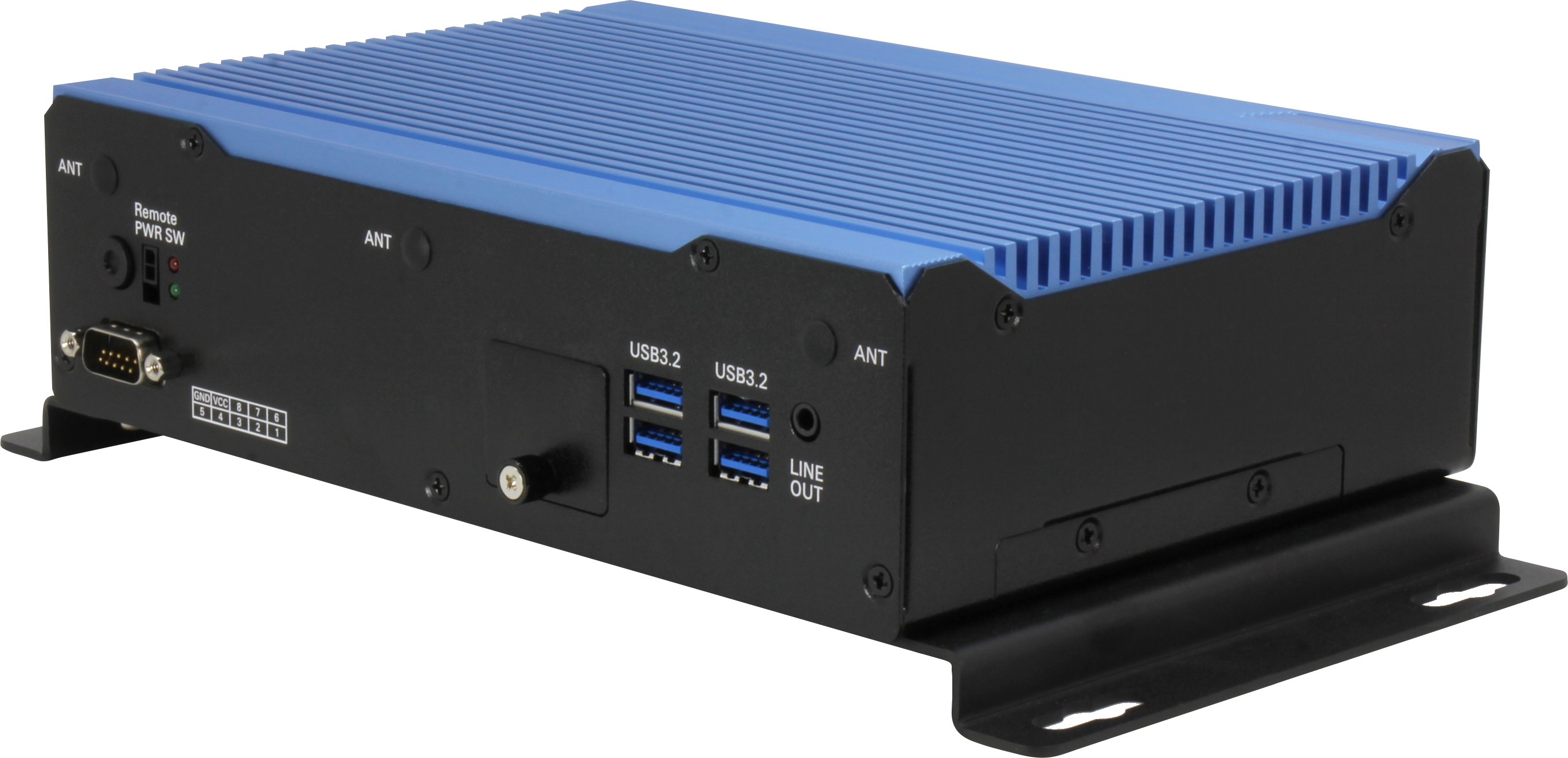

The system hosts LAN ports providing up to 2.5GbE speed, six USB (four USB 3.2 Gen 2, two USB 2.0), and three serial ports that include dual RS-232/422/485 signals and an 8-bit DIO, the BOXER-6647-MTH’s I/O provides a strong foundation with which systems integrators can install cameras, sensors (LIDAR, IMUs), and actuators for advanced robotics applications like AGVs and AMRs. Moreover, the system boasts a wealth of expansion options to accommodate Wi-Fi, 5G, and NVMe storage modules.
The mechanical design of the BOXER-6647-MTH offers a number of unique features, including external SATA and M.2 M-Key device trays that allow users to swap, upgrade, or replace SATA and M.2 NVMe storage devices without the need to open the system or use tools to configure. A second change to what users will have become accustomed to with AAEON’s fanless embedded PC line is its fully sealed chassis panels. Previous products from the selection required additional vents on the system side panel to ensure adequate heat dissipation, the BOXER-6647-MTH compensates for this with a more efficient and effective heatsink.
Despite its ventless chassis, the BOXER-6647-MTH remains relatively compact at 220mm x 154mm x 62.1mm, while also maintaining a -20°C to 60°C temperature range. The system can operate in industrial environments with fluctuating power supplies, with a 9V to 36V power input range via a 3-pin terminal block connector, while also receiving protection from damage during operation thanks to both shock and vibration resistance features.
