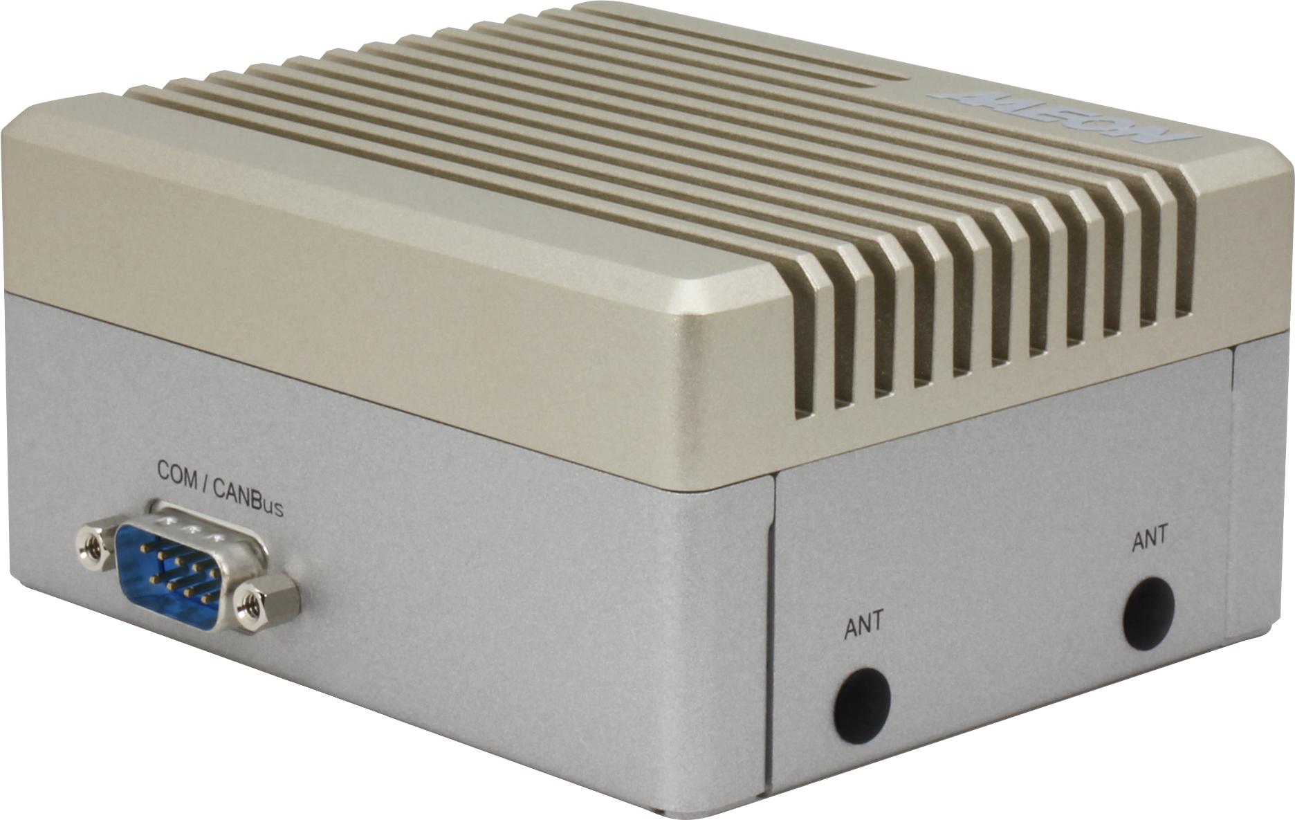

AAEON, a global leader in edge AI computing, has unveiled the BOXER-8621AI, its inaugural fanless embedded AI System powered by the NVIDIA® Jetson Orin Nano module. Geared towards applications such as AMR, fleet management, and traffic control solutions, the BOXER-8621AI seamlessly combines the NVIDIA Jetson Orin Nano’s impressive 20 TOPS of AI performance and NVIDIA Jetpack™ 5.0 SDK support with robust hardware, ensuring extended durability and longevity even in challenging environments. To bolster its resilience, the system boasts an operating temperature range of -15°C to 60°C, complemented by enhanced shock and vibration resistance.
The BOXER-8621AI is equipped with an array of interfaces tailored to its designated deployment domains. These include DB-9 and DB-15 ports for RS-232/422/485, CANBus, and GPIO, all backed by high-bandwidth LPDDR5 system memory. The system also incorporates four USB Type-A ports (two offering USB 3.2 Gen 2, and two offering USB 2.0), an RJ-45 port for gigabit LAN, and an HDMI 1.4 port for display output.
In terms of expansion capabilities, the system features an M.2 3042/3052 B-Key slot to accommodate 4G, 5G, as well as M.2 2242 B and M-Key storage modules. Additionally, it contains an M.2 2230 E-Key slot, granting Wi-Fi, Bluetooth, and additional storage as needed.
Designed for efficient space utilization, the system comes complete with a wall-mounting bracket, rendering it exceptionally suitable for constrained deployment spaces. Its compact chassis, measuring 4.13” x 3.54” x 2.05” (105mm x 90mm x 52mm), contributes to this.
