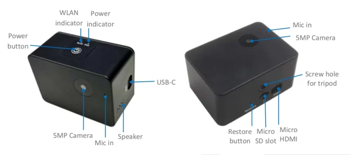

Vantron HCAM26 Wi-Fi Camera Specifications
  • SoC: Quad-core ARM Cortex-A7 32-bit vision processor
  • MCU: RISC-V MCU
  • AI Processor: 2.0 TOPS NPU, supports INT8/INT16
  • Memory: 1GB DDR4
  • Storage: 8GB eMMC, 1x Micro SD slot
  • Camera:
    • 5 MP 1/4″ CMOS image sensor
    • 2592 x 1944 (QSXGA) resolution
    • 8-/10-bit RGB RAW output format
    • Up to 30 fps at VGA, 120 fps at QCIF/QQCIF
    • Focal length: EFL 1.785mm, BFL 0.934mm
    • Field of View (FOV): 73.9° (V), 92.4° (H), 119.9° (D)
    • Aperture: F2.4, 6P lens construction
  • Video:
    • ISP up to 14 MP
    • H.265/H.264 video codec
    • 3840 x 2160 @30 fps + 1080p @30 fps encoding
    • 3840 x 2160 @30 fps decoding
  • Wi-Fi:
    • IEEE 802.11ah (Wi-Fi HaLow)
    • Station mode
    • Frequency ranges: US (902MHz ~ 928MHz), JP (916.5MHz ~ 927.5MHz)
    • Security: WPA3, AES, SHA1, SHA2
  • Audio:
    • 1x microphone input
    • 1x 1W speaker
    • Two-way audio communication
  • Interfaces:
    • 1x USB Type-C (supports image flashing)
    • 1x Micro HDMI (up to 4K @30Hz, no sound output)
  • Indicators & Controls:
    • 1x Power indicator LED
    • 1x Wi-Fi HaLow connectivity indicator LED
    • 1x Power button
    • 1x Restore button (reboot/factory reset)
  • Battery: 2600mAh Li-ion battery, up to 4 hours of operation
  • Power Input: 5V/2A DC via USB Type-C, consumption < 3W (average)
  • Operating System: Linux Yocto (support available upon request)
  • Dimensions: 91.6mm x 65mm x 47.2mm
  • Environmental:
    • Operating temperature: -10℃ to +50℃
    • Storage temperature: -20℃ to +70℃
    • Humidity: 5% to 95% RH (non-condensing)
  • Certifications: FCC, TELEC
