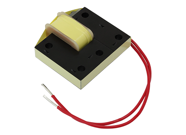

Vishay / Dale IHPT-1411AF-AB0 Haptic Feedback Actuator features solenoid construction that provides high impulse vibration for clear tactile feedback in noisy environments. The Vishay / Dale IHPT-1411AF-AB0 Haptic Feedback Actuator can drive a 0.5kg load to 6g of acceleration with a 12V, 5ms pulse.
Displays by mixos
Vishay / Dale IHPT-1411AF-AB0 Haptic Feedback Actuator features solenoid construction that provides high impulse vibration for clear tactile feedback in noisy environments. The Vishay / Dale IHPT-1411AF-AB0 Haptic Feedback Actuator can drive a 0.5kg load to 6g of acceleration with a 12V, 5ms pulse. The actuator features compact, two-piece construction for easy implementation into industrial and medical touch screen applications and touch button applications.
  • Solenoid construction provides high impulse vibration for clear tactile feedback in noisy environments
  • Compact, two-piece construction with mounting holes; stationary U core and moving I-bar for easy implementation in touch screen or touch button applications
  • The actuator can drive a 0.5kg load to 6g of acceleration with a 12V, 5ms pulse
  • Standard lead termination is dipped 100% tin solder
Specifications
  • 16V voltage rating
  • 150VDC dielectric withstand voltage, coil-to-core
  • 0.73 force coefficient
  • -40°C to +105°C temperature range
