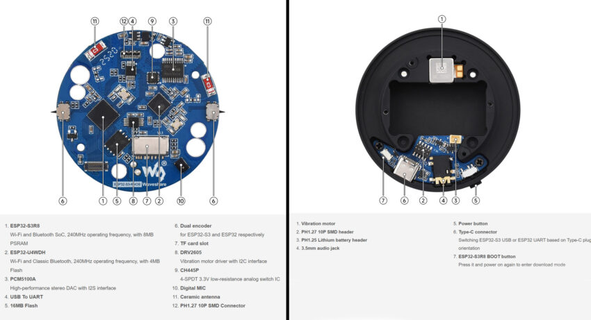

  • Main Controller:
    • ESP32-S3R8 dual-core LX7 MCU @ 240MHz with 8MB PSRAM
    • ESP32-U4WDH MCU @ 240MHz with 4MB Flash
  • Memory & Storage:
    • 16MB Flash memory
    • 8MB PSRAM (for ESP32-S3)
    • SD card slot for external storage
  • Display:
    • 1.8-inch IPS round display
    • 360 × 360 resolution, 262K color
    • Capacitive touch panel (CST816 touch controller)
    • QSPI interface
    • ST77916 display driver
  • Audio:
    • PCM5100A stereo DAC (I2S interface)
    • Digital MEMS microphone
    • 3.5mm audio jack (external speaker required)
    • Real-time audio spectrum display
  • User Interface:
    • Dual rotary encoders (one for each MCU)
    • Vibration motor (DRV2605 driver)
    • Power button
    • BOOT button for firmware download
    • Backlight brightness control via knob
  • Connectivity:
    • Wi-Fi 802.11 b/g/n (2.4GHz)
    • Bluetooth 5 (LE) and Classic Bluetooth
    • USB Type-C for programming/power
    • Automatic switch between ESP32-S3 USB and ESP32 UART via Type-C orientation
  • Battery & Power:
    • Optional 3.7V 800mAh 102035 Lithium battery
    • Battery charging management onboard
    • PH1.25 lithium battery header
  • Misc:
    • CNC aluminum alloy enclosure
    • Onboard ceramic antenna
    • PH1.27 10P SMD connector
    • CH445P analog switch IC
    • Dual encoder for ESP32-S3 and ESP32
    • Vibration motor (DRV2605 driver over I²C)

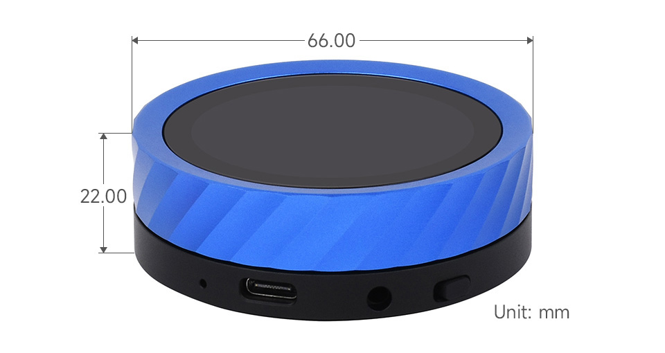

  • Dimensions: 66 x 22 mm
  • Enclosure: CNC-machined metal case

What’s interesting about this board is the dual ESP32 and the implementation of H445P 4-SPDT analog switch IC, with the support of this IC, Waveshare is using a single USB to program both the ESP32s. As mentioned earlier, there are two ESP32s: one SP32-S3R8, which probably handles the main application logic, GUI rendering, touchscreen, and rotary knob input, audio spectrum visualization, and communication. The other one should be used to handle low-level IOs
