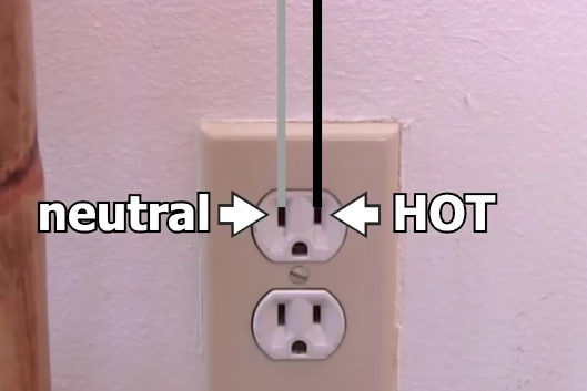

RimstarOrg published an interesting video on his Youtube channel to demonstrate why In north America you can find 3 holes in the electricity socket; which are hot, neutral and ground. The hot wire goes to a breaker-panel and then to electricity grid and finally to a transformer somewhere.

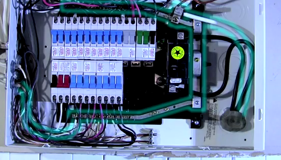

The hot wire goes to a breaker-panel and then to electricity grid and finally to a transformer somewhere. While the neutral line is connected with a bar in the breaker-panel and goes directly to the electricity grid and then to the transformer. Mostly, these wires’ colors are respectively black, white.

To understand why having a ground in household appliances is important, the video explained a use-case; a microwave-oven with 3 wires electricity plug where the electricity flows between the hot and the neutral, while the ground is connected to the external case. However, if the hot wire isolation gets damaged and attached to the case, the grounded case will make a low resistance path for the electricity. This will protect you from an electric shock because the electricity in this low resistance path will be very high forcing the breaker switches off.
