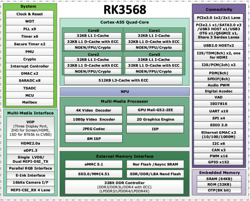

The RK3568 is a high-performance SOC with a 4-core ARM A55 CPU and a Mali G52 2EE GPU with OpenCL, Vulkan 1.1; supporting 4K decoding and 1080P encoding. It’s made with 22nm technology and has an 0.8 TOPS NPU which is great for lightweight AI applications. RK3568 supports both Android 11 and Linux systems and targets the industry with IoT and RTOS applications. The image below shows the full feature of the RK3568 SOC.

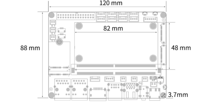

The above image shows the dimension of the board including the carrier board. This development board has compact dimensions, measuring 120mm (4.72 inches) in length and 88mm (3.46 inches) in width.
