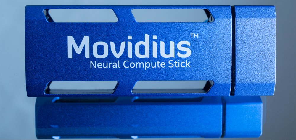

Last week, Intel launched the Movidius Neural Compute Stick, which is a deep learning processor on a USB stick.
This USB stick was not an Intel invention. In fact, Intel had acquired Movidius company that had produced last year the world’s first deep learning processor on a USB stick based around their Myriad 2 Vision Processor.
Neural Compute Stick is based around the Movidius MA2150, the entry level chip in the Movidius Myriad 2 family of vision processing units (VPUs). Using this stick will allow you to add some artificial visual intelligence to your applications like drones and security cameras.
Movidius Neural Compute Stick form factor device enables you prototype and tune your deep neural network. Moreover, the USB form factor connects to existing hosts and other prototyping platforms. At the same time, the VPU provides machine learning on a low-power inference engine.
Actually, the stick role comes after training your algorithm where it is ready to try real data. All you have to do is to translate your trained neural network from the desktop using the Movidius toolkit into an embedded application inside the stick. Later on, the toolkit will optimize this input to run on the Myriad 2 VPU. Note that your trained network should be compatible with Caffe deep learning framework.
