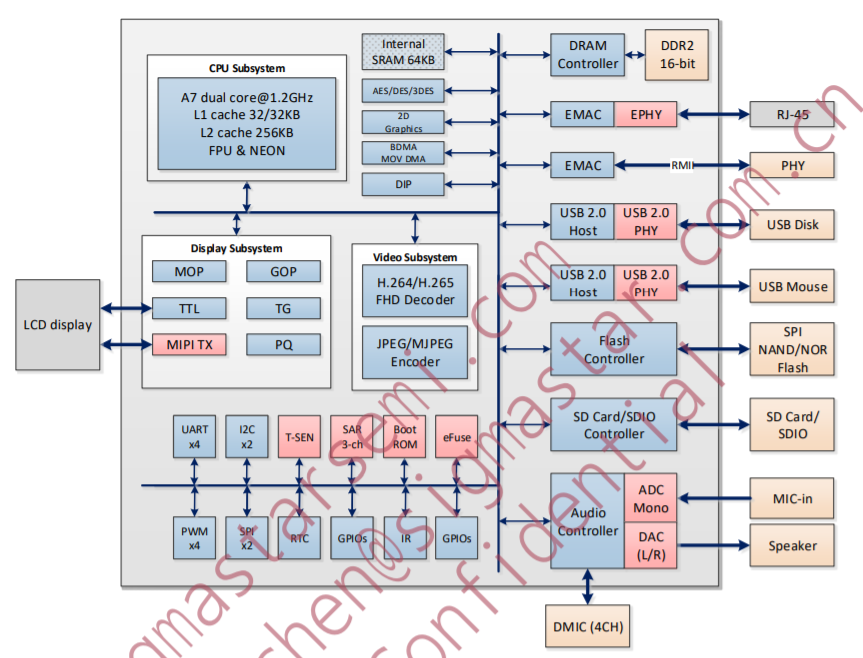

The SSD201 itself is a highly integrated SoC. It is based on a dual-core ARM Cortex-A7 processor, integrates H.264/H.265 video decoder, 2D graphics engine and TTL/MIPI display with adjustable picture quality engine, among with other peripherals that make it useful for smart display applications. The full list of specs are:

The block diagram of the SSD201
