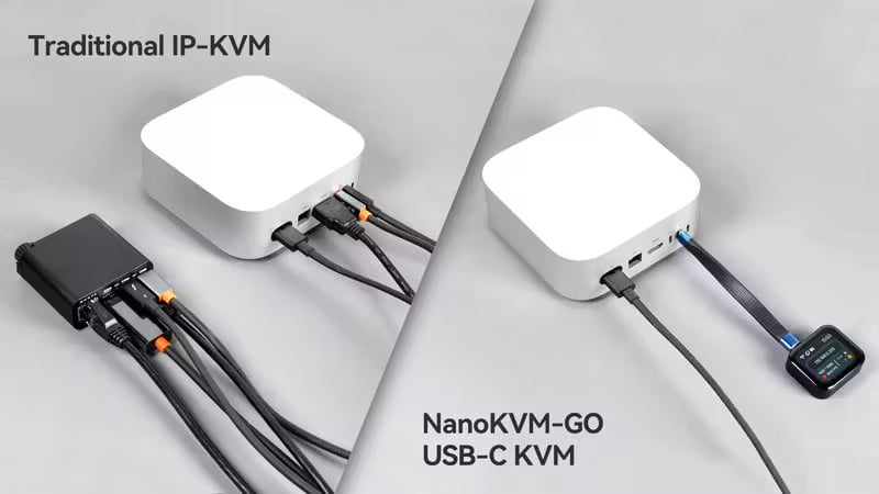

Conventional IP-KVMs vs NanoKVM-Go
NanoKVM Go is compatible with any device with USB-C DP Alt mode support, including iPhone 15+, many Android phones, MacBook, Mac Mini, Steam Deck, Windows laptops and mini PCs, and so on. It allows control from a browser. Aside from the main USB-C connection, NanoKVM-Go also has a second USB-C port for additional functionality. The campaign pitches the port as a PD passthrough for keeping phones or tablets charged while connected, and for expansion options such as a “finger robot” accessory for physically pressing a power button on systems needing a hard reboot. The company has links to a GitHub repository and the wiki for the NanoKVM Go, but both are empty for now as the crowdfunding campaign has just kicked off.
