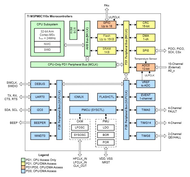

TI MSPM0C1104 specifications:
  • MCU core: 32-bit Arm Cortex-M0+ @ up to 24MHz
  • Memory: 1KB SRAM
  • Storage: Up to 16KB flash
  • Peripherals:
    • Up to 18x GPIOs
    • 2x 5V-tolerant open-drain I/Os
    • Analog:
      • 1x Analog-to-digital converter (ADC) with up to 10 total external channels, 1.7Msps at 10-bit or 1.5Msps at 12-bit with VDD as the voltage reference
      • Configurable 1.4V or 2.5V internal ADC voltage reference (VREF)
      • Integrated temperature sensor
      • Integrated supply monitor
  • Intelligent Digital Peripherals:
    • 1-channel DMA controller dedicated to ADC
    • Three timers supporting up to 14 PWM channels
    • One 16-bit advanced timer with deadband support for up to 8 PWM channels
    • One 16-bit general-purpose timer with 4 capture/compare channels
    • One 16-bit general-purpose timer with 2 capture/compare channels
    • Windowed watchdog timer
    • BEEPER generating 1kHz, 2kHz, 4kHz, or 8kHz square waves
  • Enhanced Communication Interfaces:
    • One UART interface supporting LIN, IrDA, DALI, smart card, Manchester, and low-power operation in STANDBY mode
    • One I2C interface supporting FM+ (1Mbps), SMBus, PMBus, and wakeup from STOP mode
    • One SPI interface supporting up to 12 Mbps
  • Supply voltage: 1.62V to 3.6V
  • Operating temperature range: -40°C to 125°C
  • Optimized low-power modes:
    • RUN: 87µA/MHz
    • STOP: 609µA at 4MHz, 311µA at 32kHz
    • STANDBY: 5µA with SRAM retention
    • SHUTDOWN mode: 200nA
  • Dimensions:
    • DSBGA (YCJ): 8 pins, 1.6 x 0.861 mm (1.3776 mm²)
    • SOT-23-THN (DDF): 8 pins, 2.9 x 2.8 mm (8.12 mm²)
    • SOT-23-THN (DYY): 16 pins, 4.2 x 2 mm (8.4 mm²)
    • TSSOP (PW): 20 pins, 6.5 x 6.4 mm (41.6 mm²)
    • VSSOP (DGS): 20 pins, 5.1 x 4.9 mm (24.99 mm²)
    • WQFN (RUK): 20 pins, 3 x 3 mm (9 mm²)
    • WSON (DSG): 8 pins, 2 x 2 mm (4 mm²)
