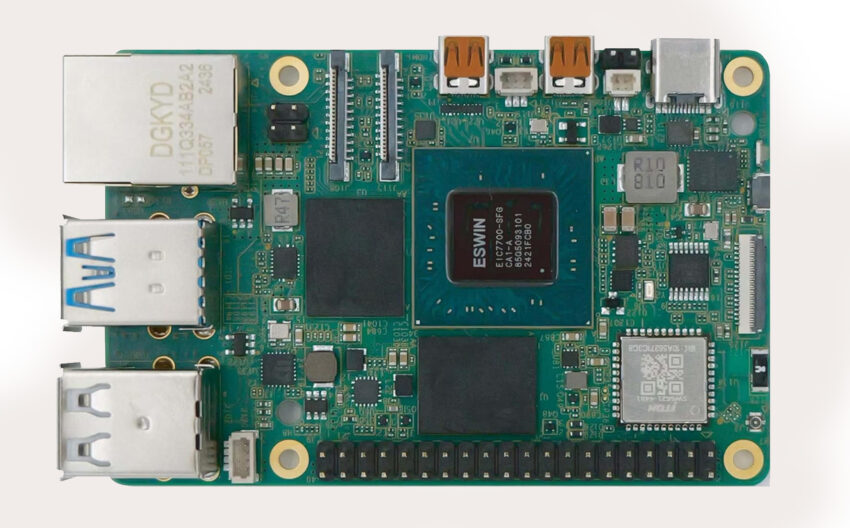

ESWIN EBC77 RISC-V Raspberry Pi SBC Top
ESWIN EBC77 SBC Top

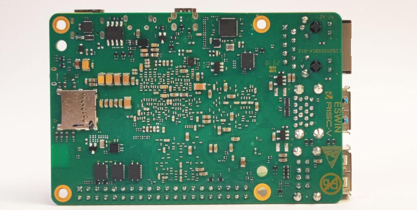

ESWIN EBC77 SBC Bottom

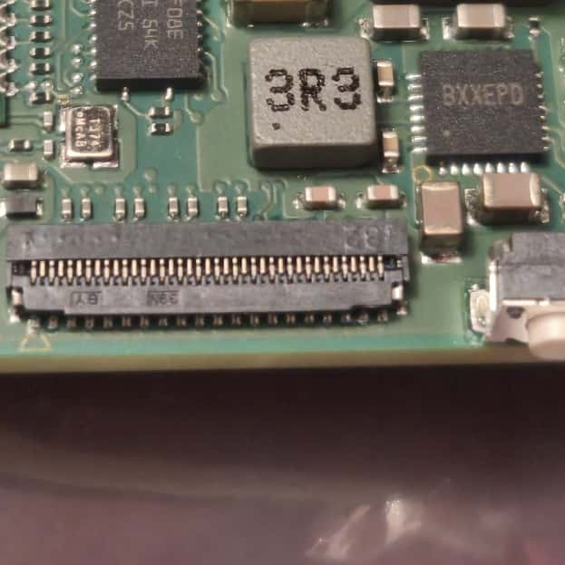

Raspberry Pi 5 PCIe HATs definitely won’t work, I can confirm. Not even physically compatible with the EBC77’s 39-pin 0.3mm pitch FPC connector. (First time I saw it I thought it was another MIPI connector for a monitor or something.) Can’t find any documentation about the pinouts either.
EBC77-PCIe-connector
