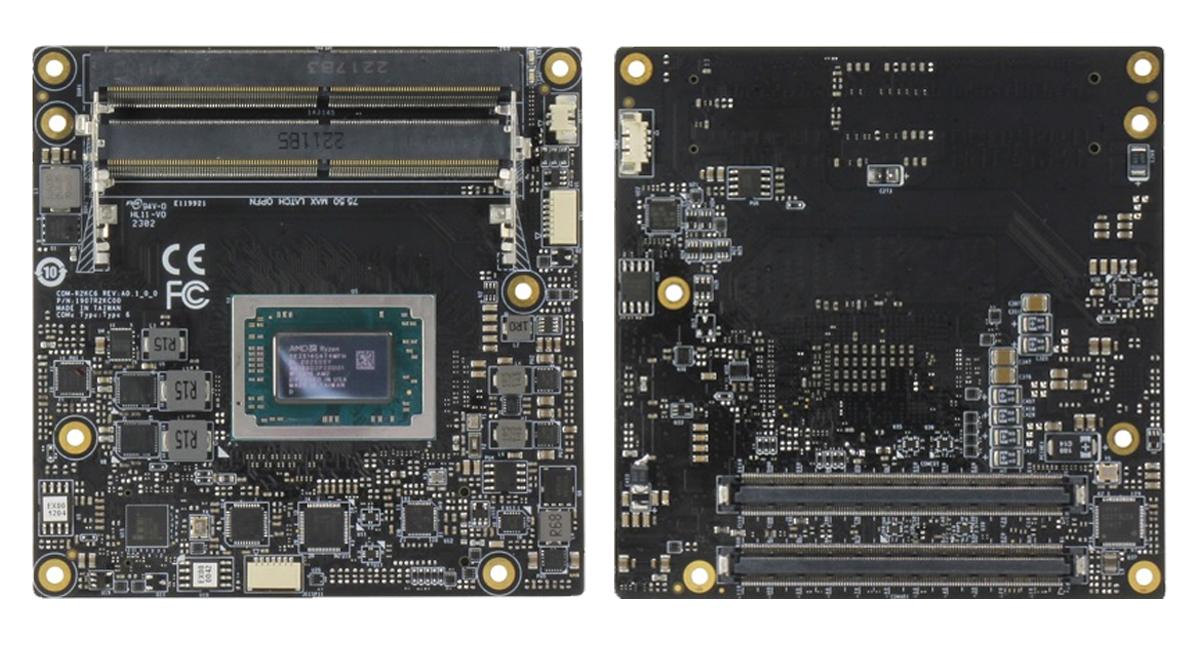

AAEON COM-R2KC6 is a new COM Express module based on the Ryzen Embedded R2000 series of processors. The device comes in a Type 6 form factor and features four 4K displays and additional graphics via a PEG x4 slot, leveraging its AMD Radeon Vega 8 graphics.
Previously we have covered many COM Express modules like the ADLINK COM Express Type 6 module, the ET880 COM Express module, the ET980 series of COM Express modules, and many others you can check if you are interested in the topic.
The R2KC6 module will support four 4K displays via eDP and three DDIs to maximize its AMD Radeon Vega 8 graphics and come in three variants: R2544 (4C/8T, 3.35 GHz, 45W), R2514 (4C/8T, 2.10 GHz, 15W), and R2314 (4C/4T, 2.10 GHz, 15W), with additional graphics support through a PEG x4 slot.
AAEON COM-R2KC6 Compact, High-Performance COM Express Module Features:
  • Form Factor: COM Express Compact, Type 6
  • CPU: AMD Ryzen Embedded R2000 Series (R2544, R2514, R2314)
  • Chipset: Integrated with Intel SoC
  • Memory: DDR4 3200MHz, 2x SODIMM, up to 32GB
  • BIOS: AMI UEFI
  • Wake on LAN: Supported
  • Watchdog Timer: 255 Levels
  • Dimensions: 3.74″ x 3.74″ (95mm x 95mm)
  • Security: TPM 2.0
  • Power: +12V/+5VSB (ATX), +12V (AT)
  • Power Consumption: 4.8A @+12V (Ryzen R2544)
  • Graphics: AMD Radeon Vega 8 / Vega 6
  • Display: Supports 4x 4K displays (eDP x1, DDI x3)
  • I/O:
    • Ethernet: Intel I226-LM/IT 2.5GbE x1
    • Audio: HD Audio Interface
    • USB: USB 2.0 x8, USB 3.2 (10Gbps x2, 5Gbps x1)
    • Serial: 2-Wire UART x2
    • Storage: SATA III x2
    • Expansion: PEG [x4], PCIe Gen3 [x1] x4, PCIe Gen3 [x4] x1, LPC
    • GPIO: 8-bit
    • SMBus/I2C: I2C x1, SMBus x1
  • Environment:
    • Operating Temp: 32°F ~ 140°F (0°C ~ 60°C)
    • Storage Temp: -40°F ~ 185°F (-40°C ~ 85°C)
    • Humidity: 0% ~ 90% RH, non-condensing
  • EMC: CE/FCC Class A
  • OS Support: Windows 10 (64-bit), Linux Ubuntu 22.04.2/Kernel 5.19.0-32
  • Weight: 0.44 lb. (0.20Kg)
The module is designed for a wide range of applications including IoT, robotics, industrial systems, machine vision, medical devices, and gaming. Its design and performance make it suitable for various applications.
