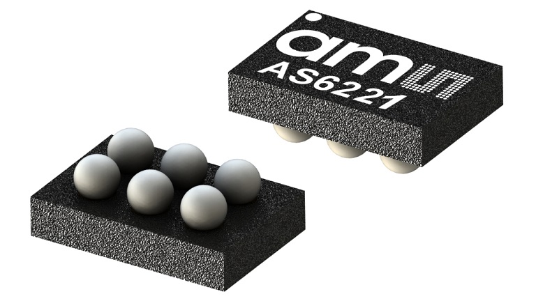

The AS6221 is a highly accurate digital temperature sensor with accuracy levels of up to 0.09 °C, which is around the usual ideal accuracy level desired for applications that require high-performance thermal information.
A complete digital sensor system, the AS6221 requires no calibration or linearization and comes in an ultra-small form factor (WLCSP 1.5 x 1.0 mm) that enables accurate body/skin temperature measurements in health and lifestyle monitoring products. Design with the current standards in mind, in addition to the high accuracy and the small form factor, the AS6221 also offers very low power consumption which makes it ideal for battery-based applications, with a current consumption of around 6μA for 4 samples per second (SPS) measurement.

To make working with the AS6221 easy, ASM has created an evaluation kit to give developers an opportunity to experiment with the sensor and develop firmware for use in their project. The board features the AS6221 temperature sensor, along with a decoupling capacitor, and pull-up resistors. It also comes with jumpers that make it easy to set the eight I²C addresses of the sensor. A 5×1 pin header with a 2.54 mm pitch offers all necessary interfaces to connect the adapter board to your application processor. The evaluation board is listed on ASM’s website with the order code AS6221-EK.
