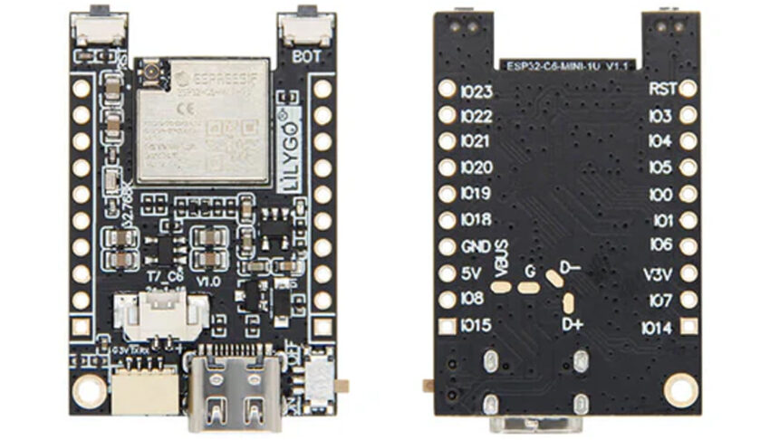

LILYGO has recently showcased the T7-C6, a compact development board featuring the ESP32-C6-MINI-1 module with 4MB Flash. It supports wireless protocols like 2.4GHz Wi-Fi 6, Bluetooth 5 (LE), and IEEE 802.15.4, making it ideal for IoT applications.
LILYGO T7-C6 board
LILYGO has recently showcased the T7-C6, a compact development board featuring the ESP32-C6-MINI-1 module with 4MB Flash. It supports wireless protocols like 2.4GHz Wi-Fi 6, Bluetooth 5 (LE), and IEEE 802.15.4, making it ideal for IoT applications. It is programmable in C/C++, Micropython, and Lua and is compatible with platforms like Arduino IDE, VS Code, and ESP-IDF. Key onboard features include Qwiic 4-pin connectors, BOOT and Reset buttons, and a switch, allowing easy integration with sensors and modules. It is shipped worldwide and includes options for built-in or external antennas for developers. This T7-C6 board can be used for IoT devices, smart home projects, and wireless communication setups.

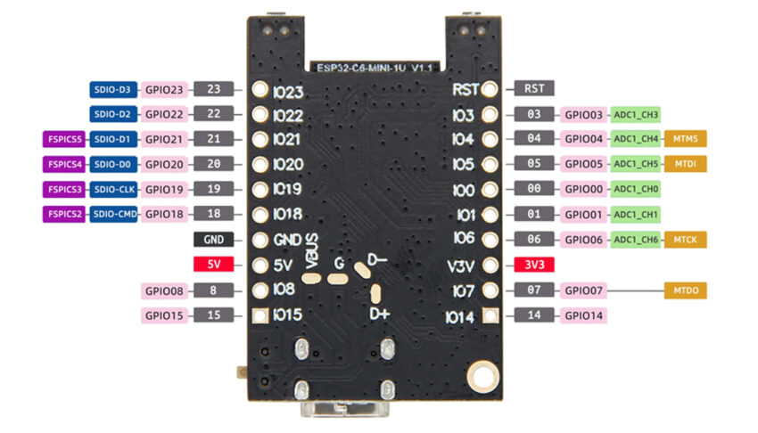

LILYGO T7-C6 Pinout
you can visit the GitHub page for more details about the board and access to sample code. If you encounter any issues, you can describe the problem in the GitHub community, where engineers are available to assist you directly.
