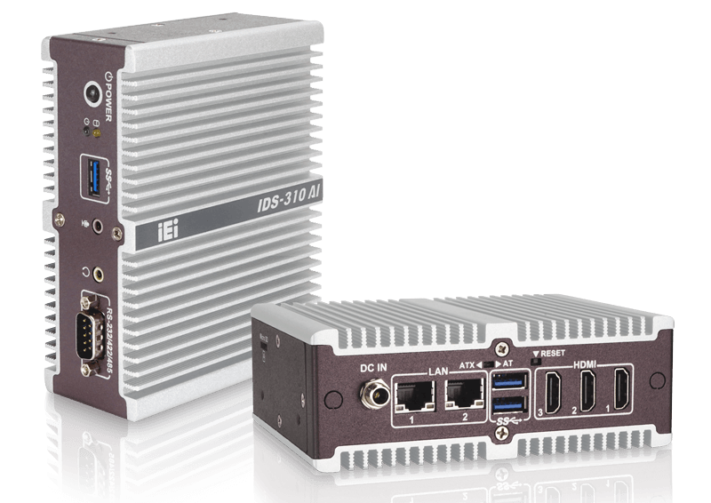

To further expand the impact of AI on this versatile tool, IEI designed an ultra-compact digital signage system called  IDS-310AI, optimized for use in energy-saving AI applications.
The IDS-310AI features an Intel Celeron J3455 Apollo Lake processor with 2x Intel Movidius Myriad X VPUs and up to three HDMI ports for image output. The Myriad X VPUs offers “excellent inference performance per watt, 16 SHAVES cores for AI calculations and native FP16 support,” and are deployed via a mini-PCIe module.
The Linux-ready mini-PC also supports Intel’s Open Visual Inference Neural Network Optimization (OpenVINO) which enables convolutional neural network-based, pre-trained models to be used at the edge with little effort. Training models like AlexNet, GoogleNet, Tiny Yolo, Squeezenet, resNet are quick and easy to implement.
Other features include a micro SD card slot, 3x USB 3.2, 2x GbE LAN ports, 1x M.2 A-key slot, pre-installed 8 GB DDR3L SO-DIMM memory, and a 128GB SATA disk on module for storing user data and loading OS.
Specifications:
  • SoC: Quad-core, 1.5GHz / 2.3GHz Intel Celeron J3455 processor with 10W TDP
  • 1 x 204-pin DDR3L SO-DIMM, 8 GB pre-installed
  • 128GB SATADOM for storing user data and loading OS
  • 1x MicroSD card slot

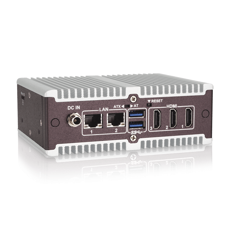

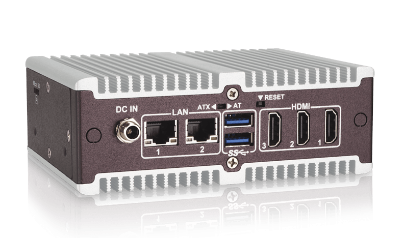

  • 3x HDMI 1.4b ports with a maximum resolution of 3840 x 2160 pixels at 30Hz each
  • 1x Mic in, 1x Line out
  • 2x RTL8111H-powered GbE ports
  • Optional 802.11ac/BT M.2 module and external antenna
  • 3x USB 3.2 Gen1 ports
  • 1x RS-232/422/485 DB-9 with AFC functionality
  • 1x M.2 2230 A-key slot with support for PCIe x1 and USB 2.0
  • 1x mini PCIe slot fitted with Mustang-MPCIE-MX2 (2x Myriad X VPU) AI accelerator card
  • Power & reset button
  • AT/ATX switch
  • Power and storage LEDs
  • Power Consumption: 2.6A @ 12V
  • Power Supply: 12V DC via screw jack
  • Security: TPM 2.0
  • Dimensions: 137 mm x 102.8 mm x 49.2 mm
  • Weight: 910g
  • Operating Temperature Range: -20°C to 45°C
  • Humidity: 10% to 95%, non-condensing
  • Operating Shock: Half-sine wave shock 5G, 11ms, 100 shocks per axis, IEC68-2-27
  • Operating Vibration: MIL-STD-810G 514.6C-1
  • Certifications: CE/FCC
  • Operating System: Windows 10 or Linux
IDS-310AI is basically a digital signage system designed for specific applications that tap the AI capabilities of the Myriad-X VPUs, but you can also use it as an embedded PC, an AIoT Edge computer, for surveillance applications, smart automation, traffic management, and more.
