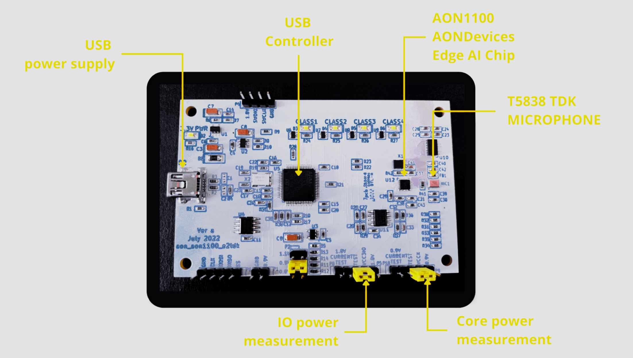

The company is offering an evaluation board featuring the edge AI processor, a TDK T5838 microphone, a USB controller, and USB power, with measurement points for core and IO power. Each kit includes a “complete AI tool suite” for dataset augmentation, training, and optimizing inference.
