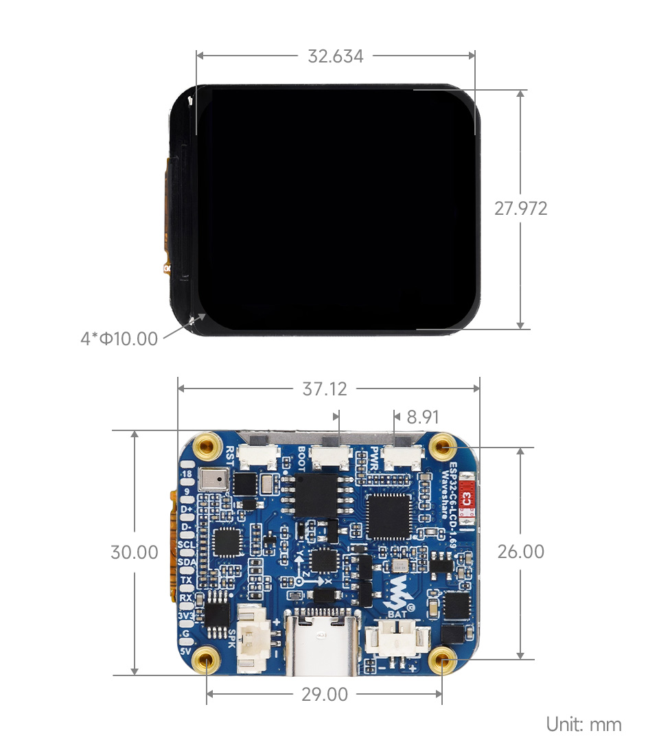

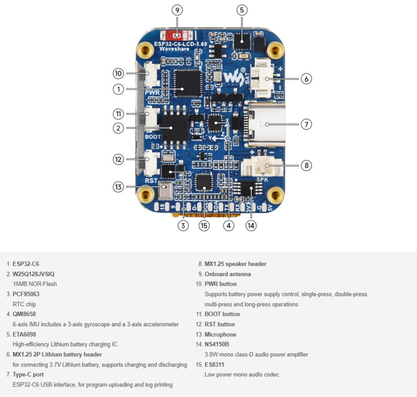

Key features include a 160MHz 32-bit RISC-V processor, 1.69-inch 240×280 IPS display (ST7789V2), Wi-Fi 6, Bluetooth 5, IEEE 802.15.4 (Zigbee 3.0, Thread), onboard 6-axis IMU (QMI8658), RTC (PCF85063), ES8311 audio codec with mic/speaker, battery charging via MX1.25 header, and flexible I/O expansion. A secondary 20MHz low-power RISC-V core is included for energy-efficient processing. It also supports AI speech and connects to platforms like DeepSeek or Doubao for online inference. SPI interface display minimizes GPIO usage, and a Type-C port handles flashing and logging.

  • Display:
    • 1.69-inch IPS LCD, 240×280, 262K colors
    • ST7789V2 driver, SPI interface
  • Audio:
    • ES8311 codec, NS4150B amp, onboard mic and speaker
  • Sensors:
    • QMI8658 6-axis IMU (accelerometer + gyroscope)
  • Power:
    • ETA6098 Li-ion battery charging IC
    • MX1.25 battery and speaker headers
  • I/O:
    • USB Type-C, BOOT/RST buttons, user button

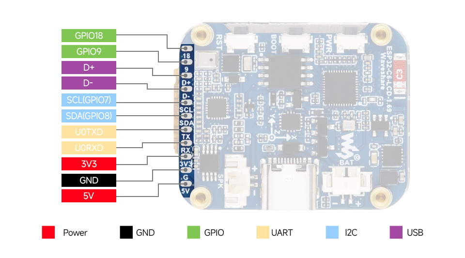

    • Reserved pads for GPIO, I2C, UART, USB
  • AI Support:
    • Online AI model integration (DeepSeek, Doubao)
  • Misc:
    • Onboard antenna, PWR button with press detection logic
    • PCF85063 RTC
  • Dimensions: 32 mm x 27mm
