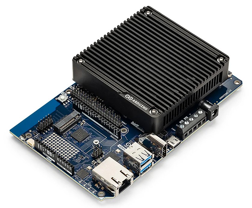

Arduino has opened pre-orders for the Arduino VENTUNO Q, a dual-processor development board aimed at edge AI, robotics, computer vision, and industrial applications. The board combines a Qualcomm Dragonwing IQ8 application processor with an STM32H5 microcontroller, creating separate computing and real-time control domains on a single platform. It also ships with Ubuntu and Arduino App Lab to simplify AI and embedded application development.
The Arduino VENTUNO Q uses the Dragonwing IQ8 IQ-8275 with an octa-core Kryo CPU, Adreno 623 GPU, Spectra 692 ISP, and Hexagon NPU that delivers up to 40 dense TOPS of AI performance. An STM32H5F5 MCU with a 250MHz Cortex-M33 core manages deterministic operations such as motor control, PWM, GPIO, sensor acquisition, and CAN-FD. An RPC bridge connects the two processors, allowing Linux applications to communicate with real-time hardware functions.

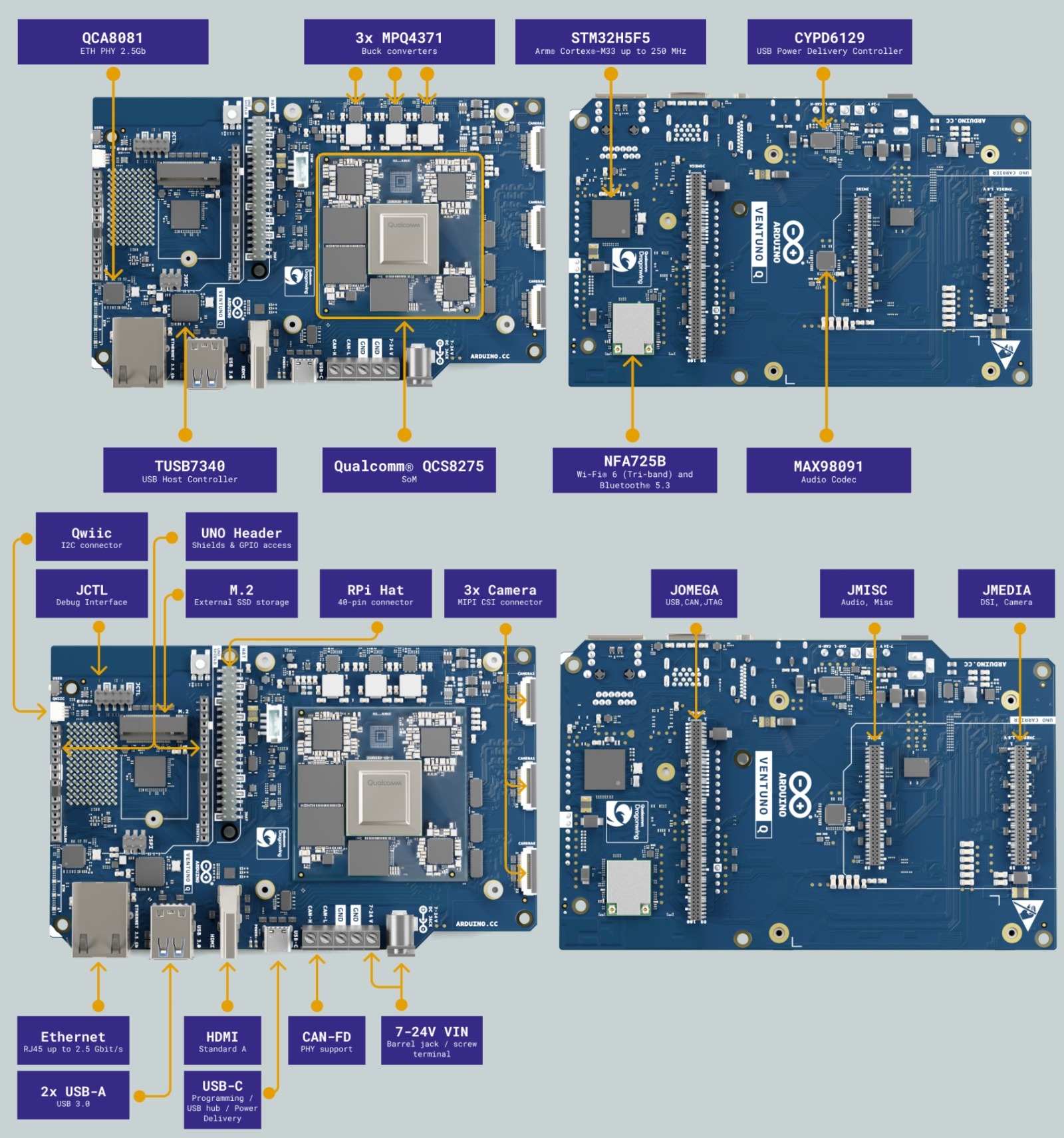

Arduino VENTUNO Q Specifications:
  • Processor:
    • Qualcomm Dragonwing IQ8 (QCS8275)
    • Octa-core Kryo Gen 6 CPU
    • Adreno 623 GPU
    • Hexagon Tensor AI processor with up to 40 Dense TOPS
    • Qualcomm Spectra 692 ISP
  • Real-Time Microcontroller:
    • STM32H5F5 MCU
    • Arm Cortex-M33 core running at 250MHz
    • 4MB flash
    • 1.5MB RAM
    • Arduino Core running on Zephyr RTOS
  • Memory and Storage:
    • 16GB LPDDR5 RAM in a 2 × 8GB configuration
    • 64GB eMMC onboard storage
    • M.2 connector for NVMe Gen4 SSDs
  • Wireless and Networking:
    • Wi-Fi 6 with 2.4GHz, 5GHz, and 6GHz support
    • Bluetooth 5.3
    • Onboard antennas
    • 2.5GbE RJ45 Ethernet
  • Camera:
    • Three MIPI-CSI connectors
    • Two additional MIPI-CSI interfaces through the JMEDIA header
    • USB camera support
  • Display:
    • HDMI output
    • DisplayPort Alt Mode through USB-C
    • MIPI-DSI through the JMEDIA header
  • USB:
    • One USB-C port with host/device role switching
    • USB-C power-role switching and video output
    • Two USB 3.0 Type-A ports
    • Two additional USB 3.0 interfaces through the JOMEGA header
  • CAN-FD:
    • One CAN-FD interface with onboard PHY through a screw terminal
    • Three CAN-FD interfaces without PHY through JOMEGA
    • One CAN-FD interface without PHY through Arduino UNO shield headers
  • Expansion and Interfaces:
    • Arduino UNO shield compatibility
    • 40-pin Raspberry Pi HAT-compatible header
    • Qwiic connector with 3.3V I2C
    • JMEDIA, JOMEGA, and JMISC expansion headers
    • I2C/I3C, SPI, PWM, and UART
    • JTAG port and MPU remote-debug connector
  • Audio and User Controls:
    • Two microphone inputs
    • Headphone, earphone, and line outputs
    • Four user-controllable RGB LEDs
    • 8 × 13 blue LED matrix
    • User push-button
    • Reset button
  • Power Supply:
    • USB-C: 5V DC, up to 3A
    • Barrel jack: 12–24V DC
    • Screw terminal: 7–24V DC
    • JOMEGA: 7–24V DC
  • Operating temperature: -10°C to +60°C
  • Dimensions: 160 × 100 × 25.8mm

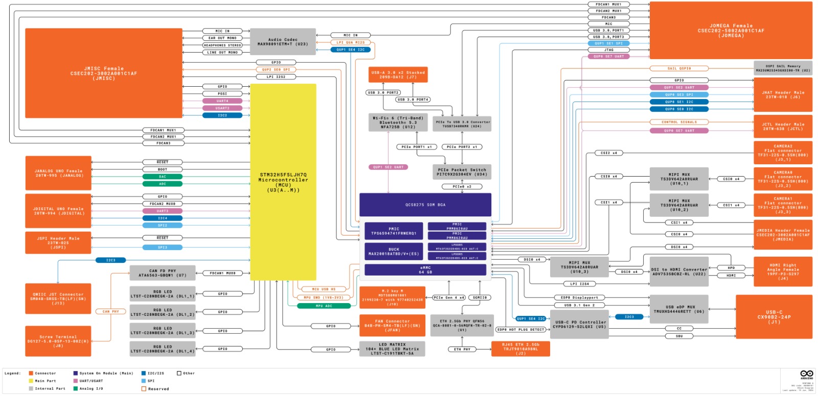

Complete Overview of Block Diagram

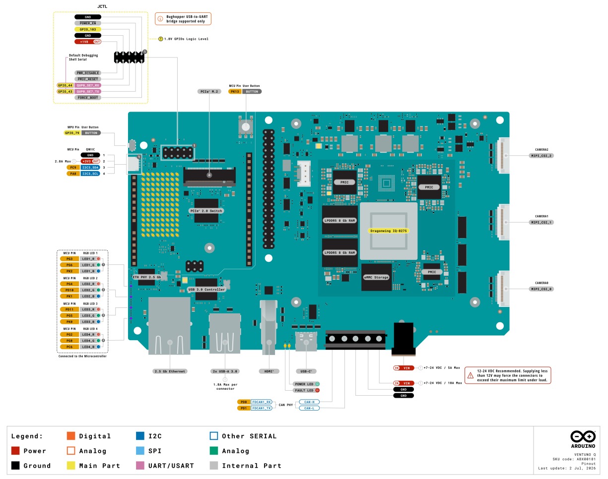

Pinout
