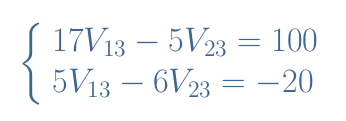

According to step 4, we write the Kirchoff’s current law at nodes 1 and 2:
  • Node 1: I1-I2-I3=0 ⇒ [(10-V13)/R1]-[V13/R2]-[(V13-V23)/R3]=0
  • Node 2: I3-I4-I5=0 ⇒ [(V13-V23)/R3]-[V23/R4]+S2=0
We obtain therefore a linear system of 2 equations with 2 unknown parameters that can be rewritten clearer by multiplying the lines with appropriate factors, arranging the terms and replacing the resistor and sources terms by their value:

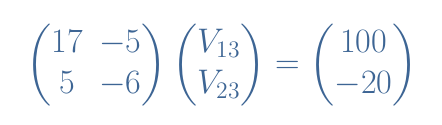

This system can be rewritten as a matrix equation:
eq 1: Matrix equation of our example
This type of equation can easily be solved by hand or using a computer program such as MatLab, the solution is V13=9.1 V and V23=10.1 V.
Since every current is a function of these values, we can compute and list them:
  • I1=(10-9.1)/1=0.9 A
  • I2=9.1/5=1.8 A
  • I3=(9.1-10.1)/2=-0.5 A
  • I4=10.1/10=1 A
  • I5=-2 A

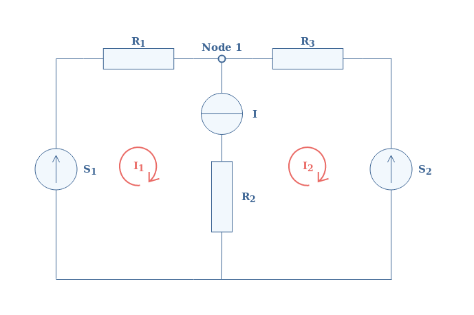

Example
Consider the following circuit illustrated in Figure 2 for which we will perform an MCA. The values of the different elements are given: S1=12 V and S2=6 V; R1=15 Ω, R2=2 Ω, and R3=12 Ω.
fig 2: Example of a circuit to perform an MCA on
Step number one has already been done in the circuit where the mesh currents are labeled with the red loop symbols.
As step number 2 suggests, we apply KVL for each mesh of the circuit:
  • Equation 1: -V1+I1×(R1+R2)-I2×R2=0
  • Equation 2: V2-I1×R2+I2×(R2+R3)=0
In our case, both mesh currents Iand I2 are present across the resistor R2, in both equations we can see that the current across R2 is considered as the algebraic sum of I1 and I2.
In the following, we replace the parameters by their value, first of all, we express I1 as a function of I2 thanks to the first equation:
  • I1=(12+2×I2)/17
We substitute this term in Equation 2, which after redistributing the terms, leads to find I2=-1/3 A. We put this value in the expression of I1 to find I1=2/3 A.
Finally, we can give the required current I to drive the circuit I=I1-I2=1 A.
