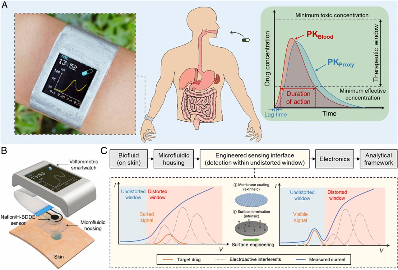

voltammetric sensing interface
The engineers devised a surface engineering strategy, which enabled them to create a voltammetric sensing interface, featuring an “undistorted potential window,” within which the target electroactive drug’s voltammetric response is dominant and interference is eliminated, rendering reliable target quantification in noninvasively retrievable biofluids (sweat and saliva).
“Leveraging this sensing interface, a fully integrated, wearable solution was constructed to seamlessly render drug readouts with minute-level temporal resolution. To inform its clinical utility, the solution was utilized to demonstrate noninvasive pharmacokinetic monitoring of a pharmaceutical (here, acetaminophen, a widely used analgesic and antipyretic) in a wearable format.”
The smartwatch features an on-board LCD panel for live monitoring and a Bluetooth connection that transmits to an external data capture system for later analysis. At the core of the smartwatch is a Microchip ATmega328-based microcontroller which is connected to a 16-bit Texas Instrument DAC8552 digital-to-analog converter. It also features a Linear Technology LT1462 transfer impedance amplifier, a TI 12-bit ADS1015 analog-to-digital converter, and a Wurth Electronik AMB2621 Bluetooth module for communication. The smartwatch takes advantage of the small molecular structure of many drugs, which enables them to be present in our sweat. This enables the device to analyze the drug due to the quantities found in the sweat, and also detect how much of the drug is still circulating in the wearer’s system. The engineers carried out the test of the watch by tracking acetaminophen (an over-the-counter painkiller) over a short period, using a small electric current to force the wearer to sweat under the sensor.
