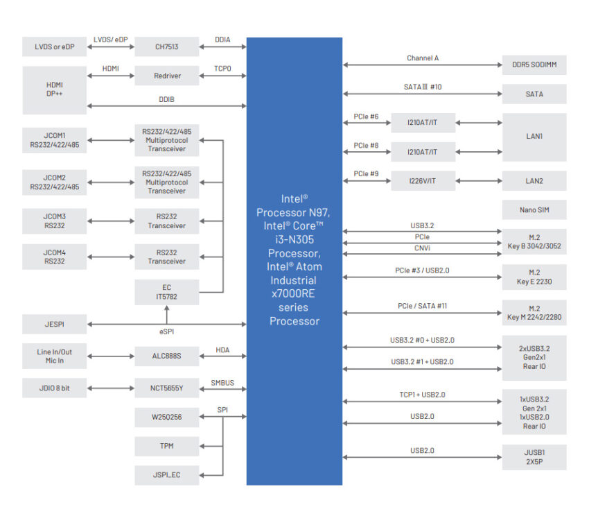

Avalue ECM-ASL3 Block Diagram

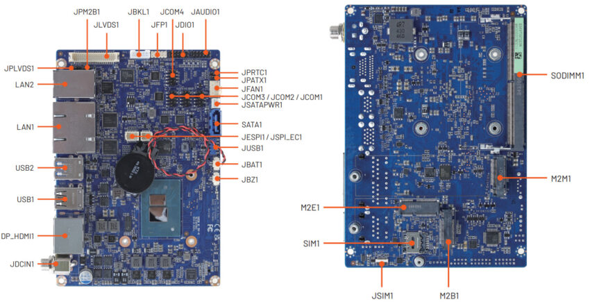

ECM-ASL3 Hardware Overview Top(Left) Bottom(Right)
