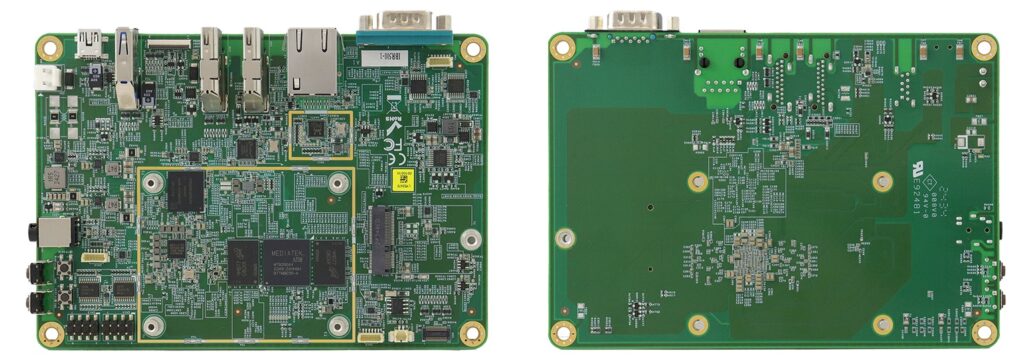

IBASE IBR500 3.5-inch SBC front and back
IBASE IBR500 3.5-inch SBC front and back side

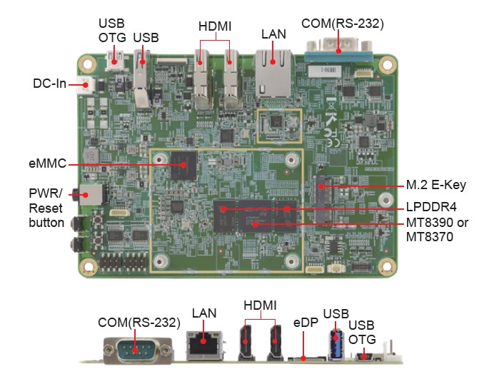

IBASE IBR500 SBC Specifications:
  • SoC: MediaTek Genio 700 / MT8390 or MediaTek Genio 510 / MT8370
    • 2x A78 2.2GHz L2 256KB, 6x A55 2.0GHz L2 128KB, shared 2MB L3 cache [MediaTek Genio 700]
    • 2x Arm Cortex-A78, 2.0 GHz, 4 x Arm Cortex-A55, 2.0 GHz [MediaTek Genio 510]
  • GPU: Integrated ARM Mali-G57 MC3 supporting OpenGL ES 1.1/2.0/3.2, Vulkan 1.0/1.1
  • System Memory:
    • LPDDR4 4000MT/s on-board 4GB~8GB
    • 4ch 16-bits LPDDR4X@3733MHz, up to 8GB, 29.8GB/s DRAM BW
  • Storage: 64GB or 128GB of onboard eMMC 5.1 Flash [SPI-NOR]
  • Display: 1x HDMI 2.0 (4K60p) + 1x HDMI 1.4 (4K30p)
  • Video Codec:
    • Decode: 4K75fps, AV1. VP9, H.265, H.264
    • Encode: 4K30fps, H.265, H.264
  • USB:
    • 1x USB 3.0, Type-A
    • 1x micro USB OTG
  • Network Connectivity:
    • 1x Gigabit Ethernet (10/100/1000Mbps)
    • Wi-Fi 6 + Bluetooth 5.2 via M.2 E-Key (2230)
  • Expansion:
    • 1x M.2 E-Key (2230) w/ SDIO, UART (for Wireless)
    • 6x GPIO in 2x pin header
    • 1x I²C in 2x 2-pin header
    • 1x SPI in 2x 2 pin header
    • 1x COM port; RS-232 (debug) port
    • 1x Audio Line-Out
  • Misc:
    • 2x On/Off button
    • 1x PWR/Reset button
    • 1x Watchdog timer (256 levels, 0–128 seconds)
    • 2x LEDS
    • Home and Power key in 2×2 Header
  • Power: 12V DC-in by DC-Connector
  • Operating Temperature: With heat sink or through housing design: -10°C~+50°C (14°F ~122°F)
  • Relative Humidity: 10%~90% (non-condensing)
  • Enclosure: Ruggedized, Fanless design, 3.5-inch SBC
  • Dimensions: 147mm x 102mm x 30mm (5.78” x 4”)
  • Certification: CE/ FCC Class-B
