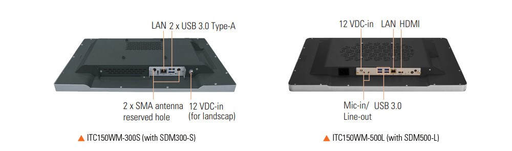

The ITC150WM-300S is powered by the onboard Intel® Pentium® processor N4200 and Celeron® processor N3350 with the Intel® HD Graphics 505 or 500 chipset. This SDM-S based panel PC can operate quietly and reliably in rigorous environments. It features one 4GB or 8G LPDDR4 memory onboard, plus an onboard 64GB eMMC. The ITC150WM-300S supports rich I/O interfaces, including three USB 3.0 Type A, two USB 2.0 type A, one HDMI, one GbE LAN, one push-push type micro SD card slot, and two SMA-type antenna openings. The ITC150WM-500L is powered by the Intel® Celeron® 4305UE with the Intel® UHD Graphics 610 chipset. This SDM-L based panel PC has two 260-pin DDR4-2400 SO-DIMM slots with up to 64GB of memory capacity and one M.2 Key M2280 slot for extensive storage. This all-in-one touch panel PC comes with five USB 3.0 Type A, two USB 2.0 type A, one GbE LAN, one HDMI, one audio, one micro microphone input, and one push-push type micro SD card slot.

The ITC150WM-300S and ITC150WM-500L have two 1.5-watt stereo speakers with a sound pressure level of 96dB and 4 Ohms impedance. Both panel PCs also have one M.2 Key E 2230 slot for Wi-Fi. Moreover, these reliable panel PCs support add-on modules and flexible mounting kits to meet user requirements and easy deployment. They also have a +12V DC power supply input. The ITC150WM-300S and ITC150WM-500L are now available for purchase. For more product information or customization services, please visit our global website at www.axiomtek.com or contact one of our sales representatives at info@axiomtek.com.tw.
