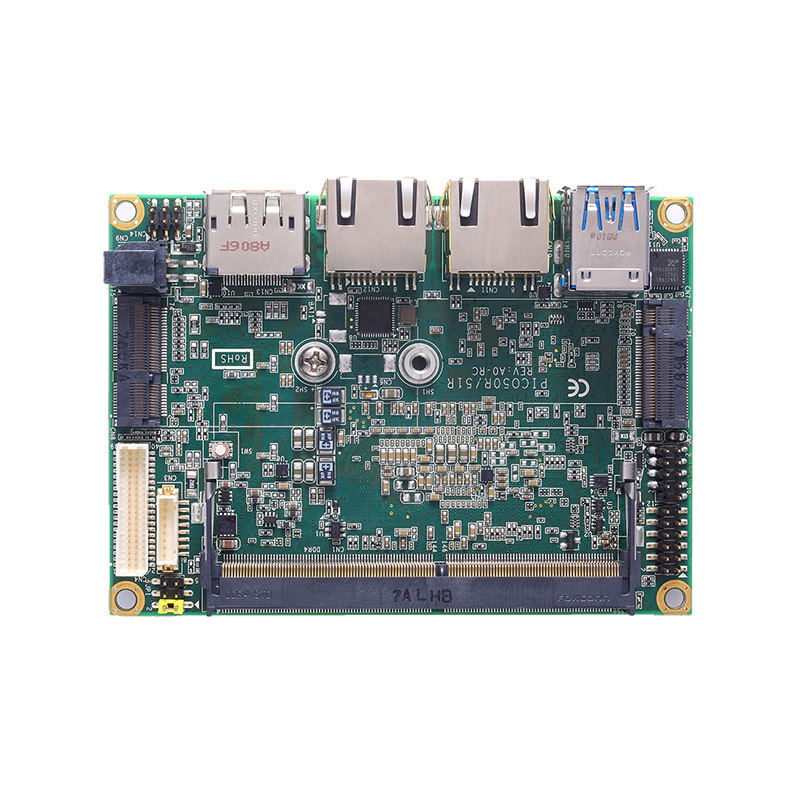

Axiomtek - a world-renowned leader relentlessly devoted in the research, development and manufacture of series of innovative and reliable industrial computer products of high efficiency - is introducing the PICO51R, an ultra-compact 2.5-inch pico-ITX motherboard powered by the 7th generation Intel® Core™ i7/i5/i3 or Celeron® processor (code name: Kaby Lake). With the onboard CPU attached on the rear side of the board, the PICO51R can aid the heat-extraction process to make fanless design possible and make system integration fast.
Axiomtek – a world-renowned leader relentlessly devoted in the research, development and manufacture of series of innovative and reliable industrial computer products of high efficiency – is introducing the PICO51R, an ultra-compact 2.5-inch pico-ITX motherboard powered by the 7th generation Intel® Core™ i7/i5/i3 or Celeron® processor (code name: Kaby Lake). With the onboard CPU attached on the rear side of the board, the PICO51R can aid the heat-extraction process to make fanless design possible and make system integration fast. The pico-ITX embedded board also provides practical expansion interfaces within its limited dimensions including one M.2 Key E slot for wireless modules and one M.2 key B slot for storage cards. The compact-sized rugged PICO51R is the perfect platform for industrial automation applications requiring a small form factor to fit in space-limited environments.
“Axiomtek’s PICO51R with high flexibility and expansion possibilities offers diversity and flexibility for system integration. This powerful 2.5-inch Pico-ITX embedded motherboard is designed for minimum maintenance and maximum ruggedness,” said Michelle Mi, a product manager of ECSE Division at Axiomtek. “In addition to two USB 3.0 (USB 3.1 Gen1) ports in support of industrial cameras for machine vision applications, the PICO51R also comes with an M.2 Key E slot for wireless communication capabilities and two Gigabit Ethernet ports for mass data transmission or LAN port teaming functions.”
The Intel® Core™-based PICO51R supports one 260-pin DDR4-2133 SO-DIMM for up to 16GB of system memory. Moreover, the pico-ITX single board computer utilizes Intel® HD graphics engine to bring a true high definition visual experience with dual display configurations through DisplayPort and 18/24-bit single/dual channel LVDS. In addition, this industrial motherboard can withstand a wide operating temperature range from -20°C to +60°C (-4°F to 140°F) for use in rugged and harsh environments.
The PICO51R adopts a rich array of I/O interfaces including two USB 3.0 ports, two USB 2.0 ports, two Gigabit Ethernet ports with Intel® Ethernet Connection I219-LM and Intel® Ethernet Controller I211-AT, two RS-232/422/485 ports, one I2C port and 4-bit DIO port. The board requires only +12V DC power supply input. To ensure reliable operation, it supports a watchdog timer to detect and recover from computer malfunctions and supports hardware monitoring features to monitor temperature, voltage, fan speed, and more. Furthermore, it supports Intel® Active Management Technology 11 (Intel® AMT 11) for remote management.

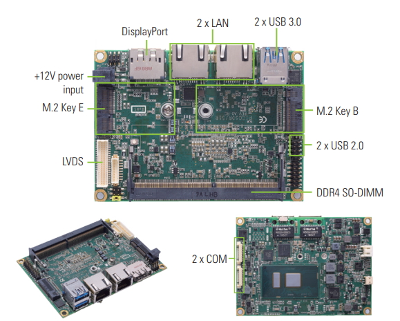

  • 7th generation Intel® Core™ i7/i5/i3 and Celeron® processor (codename: Kaby Lake) onboard
  • One DDR4 SO-DIMM for up to 16GB of memory
  • Two USB 3.0, two USB 2.0 and two COM (RS-232/422/485) ports
  • One M.2 Key E
  • One M.2 Key B
  • Supports Intel® Active Management Technology 11 (Intel® AMT 11)
  • Features +12V DC power supply input with AT Auto Power On
  • Extended operating temperature ranging from -20°C to +60°C
