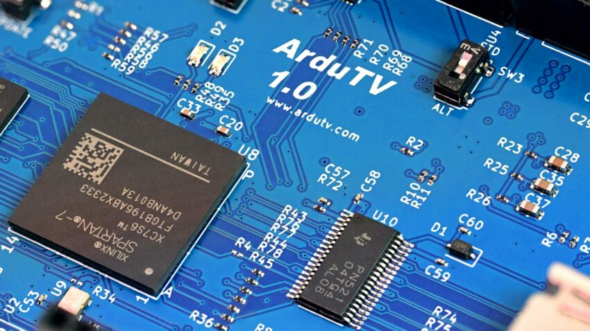

The ArduTV solves this problem by offloading video processing to an FPGA. The hardware can display graphics or text with a resolution of 640×480 using an HDMI output. The shield operates as a plug-and-play device with minimal hardware and software setup. The FPGA handles all video rendering so the Arduino only needs to send SPI commands.
More about ArduTV
The shield utilizes the AMD Spartan-7 FPGA processor to process and render graphics independently, thereby reducing the load on the Arduino. The output is transmitted via an HDMI port, functioning as a DVI signal over HDMI. This interface is compatible with the Arduino IDE and supports a library for STM32CubeIDE, making it suitable for use with STM32 Nucleo boards.
