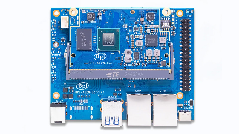

Banana Pi BPI-AI2N development kit, showing the BPI-AI2N-Core SoM in the SO-DIMM slot of the BPI-AI2N-Carrier board

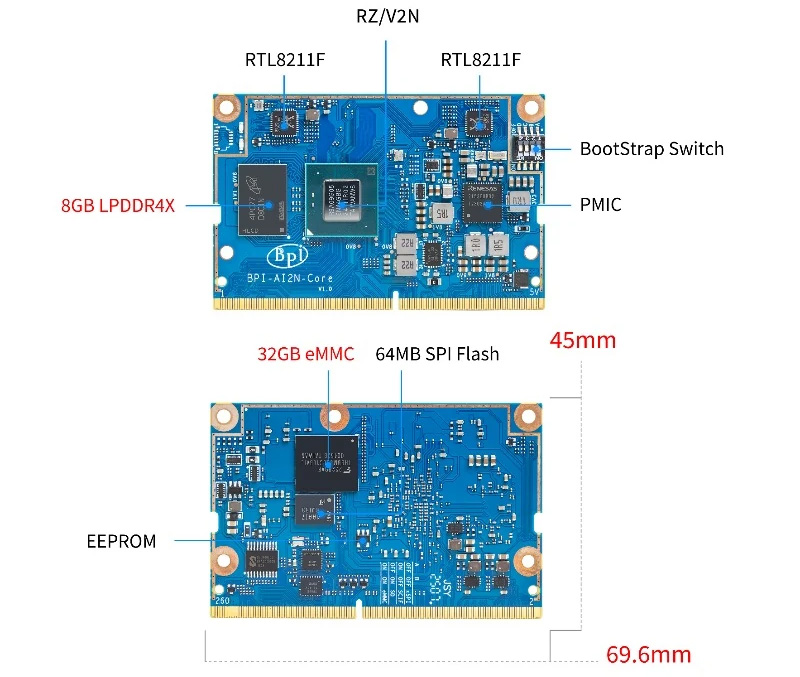

The top and bottom of the Banana Pi BPI-AI2N-Core module include key components, including the Renesas RZ/V2N SoC, memory, storage, and networking interfaces.

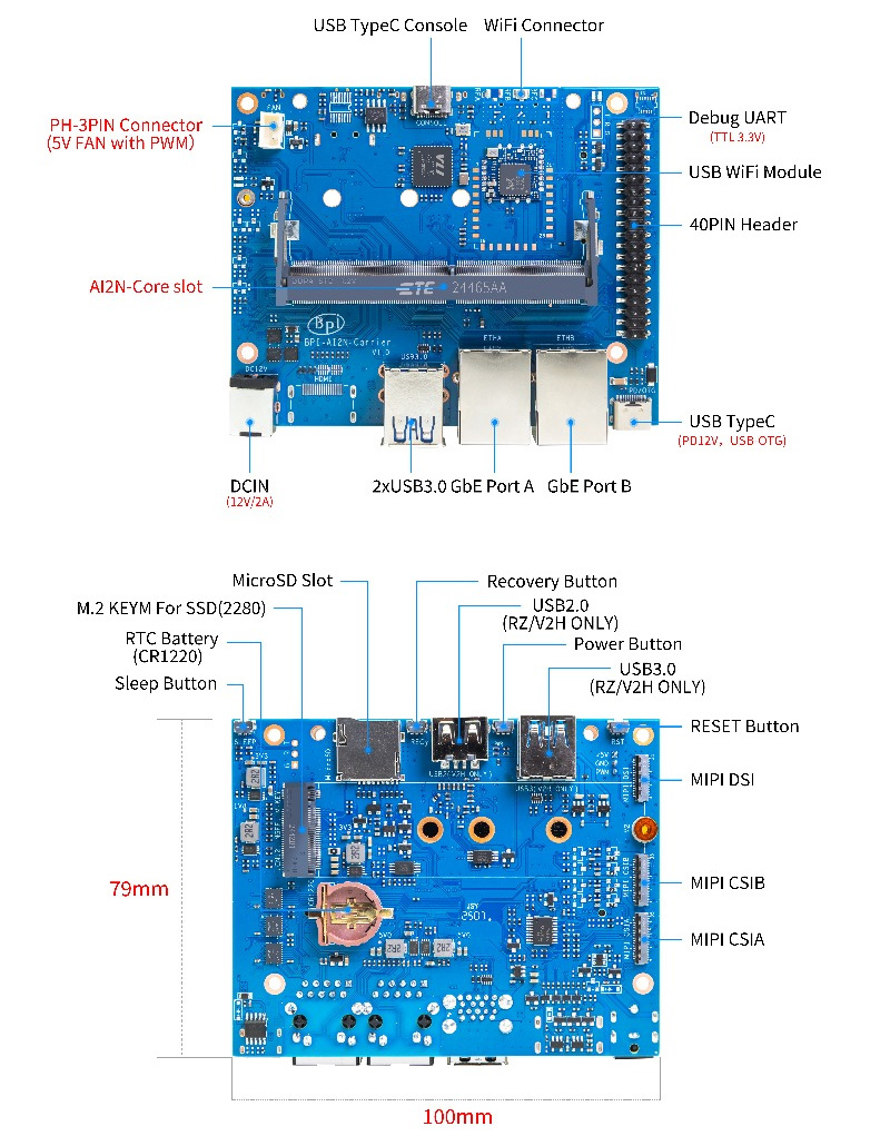

Top and bottom layout diagrams of the Banana Pi BPI-AI2N-Carrier board, with its extensive I/O interfaces, expansion slots, and networking ports.
