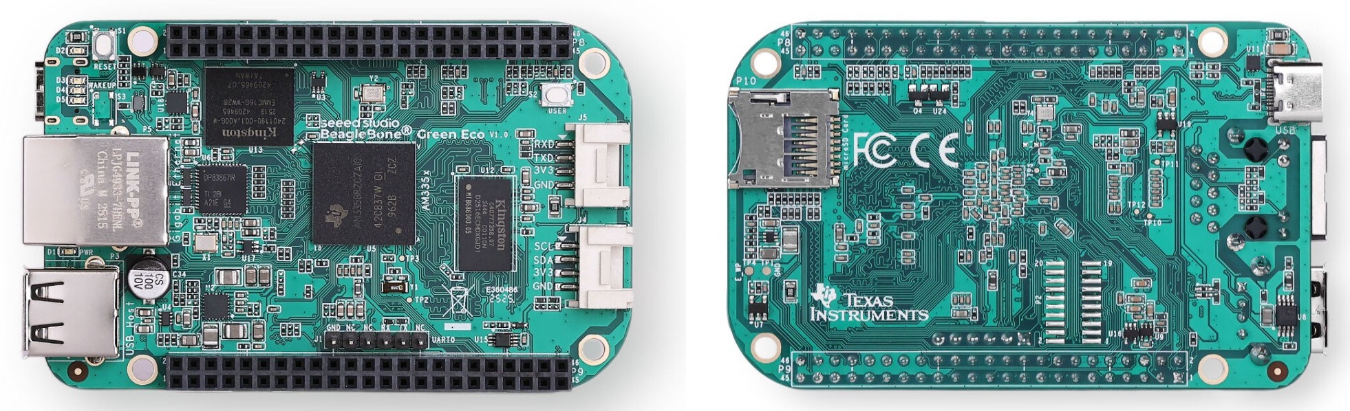

BeagleBone Green Eco open-source SBC front and back side

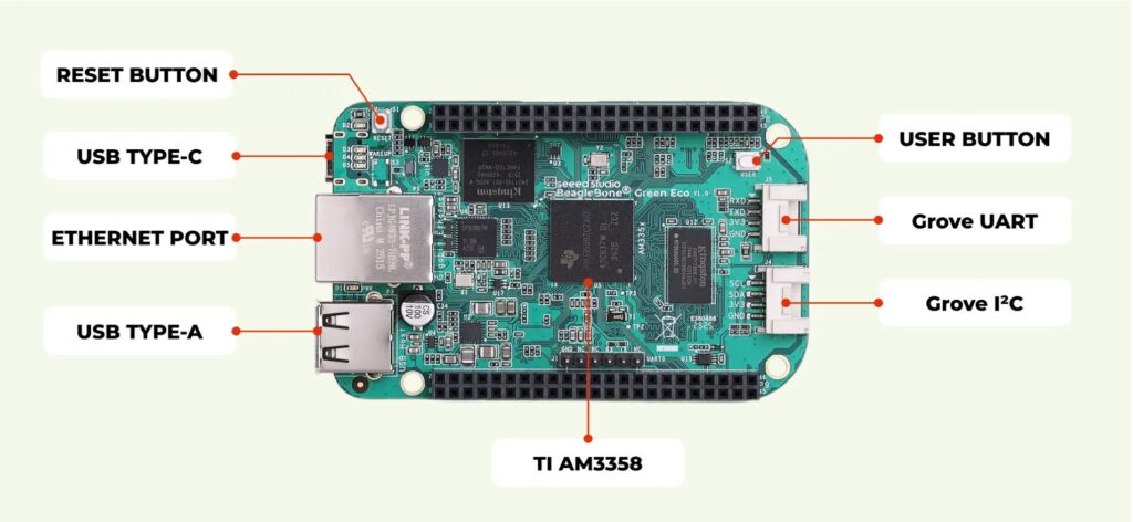

BeagleBone Green Eco open-source SBC SpecificationsSeeed Studio BeagleBone Green Eco Hardware-Overview

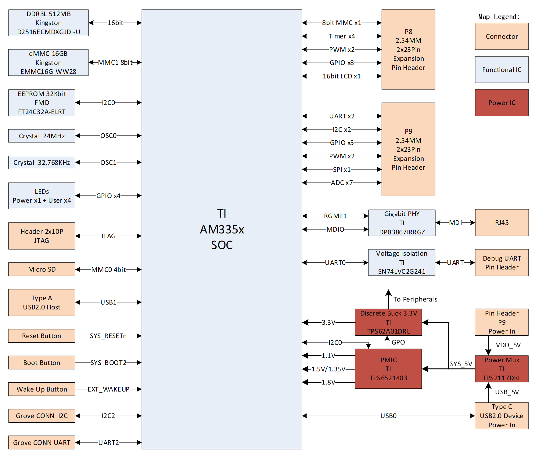

Seeed Studio BeagleBone Green Eco Functional-Block-Diagram

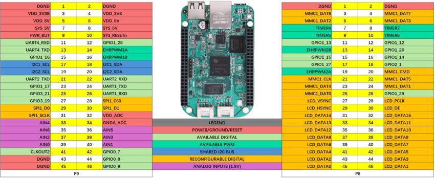

Seeed Studio BeagleBone Green Eco Header Pin Definition
